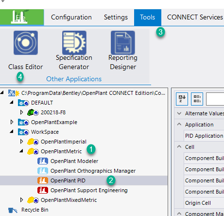

  1. Launch OpenPlant Project Administrator from desktop icon
  2. Select any WorkSet and click on OpenPlant PID, click tools and then open Class editor. Open OpenPlant_PID.01.08 schema from C:\ProgramData\Bentley\OpenPlant CONNECT Edition\Configuration\WorkSpaces\WorkSpace\WorkSets\OpenPlantMetric\Standards\OpenPlant\Schemas.

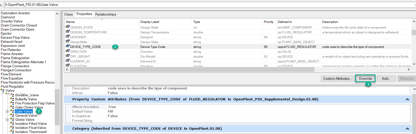

  4. From search option look for “Gate Valve” class and hit Go To.

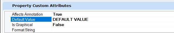

  5. Click on Gate Valve, from the properties tab click on DEVICE_TYPE_CODE and hit on override to change the default value to desired value.
  6. Let’s change HV to DEFAULT VALUE for illustration and save the changes in schemas.

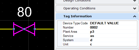

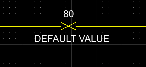

  7. Verify results by launching OpenPlant PID and place gate valve.
