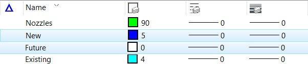

  1. Create desired Level & Element Template in OpenPlant PID CONNECT
  2. Schema changes using Bentley Class Editor
  1. Launch OpenPlant PID CONNECT Edition with desired workset.

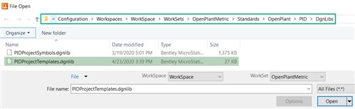

  2. Open PIDProjectTemplates.dgnlib of desired workset from below mentioned location.
  3. From workflows, select Admin as shown below.
  4. From Primary group pane, select Level Manager as shown below.
  5. From Level Manager Dialog, click on Levels > New to define a new level.
  6. Define desired name & symbology for levels, refer image below.
  7. Once done with desired level name & symbology, close the level manager.

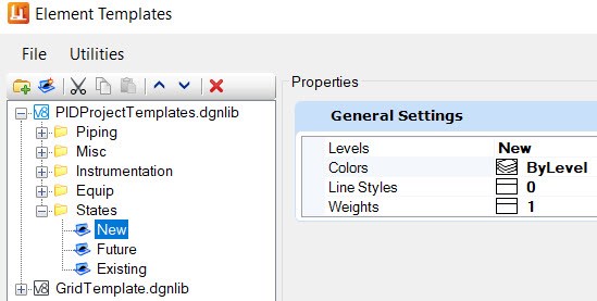

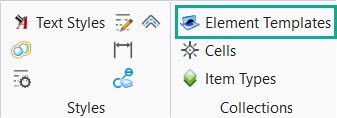

  8. From Collections group pane, click on Element Templates as shown below.
  9. In Element Template dialog, create a New Template Group & name as States. Also, define New Template for create template group as shown below.
  10. Once done, close OpenPlant PID CONNECT Edition.

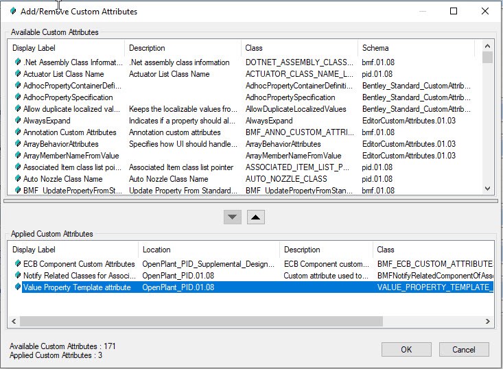

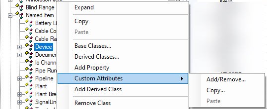

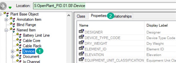

  13. Navigate to DEVICE class. Right click and select Add/Remove Custom Attributes.
  14. Add Value Property Template Attribute.
  15. Add element as in the Custom Attribute and modify it as shown below.
  16. Switch to Properties tab as shown below.

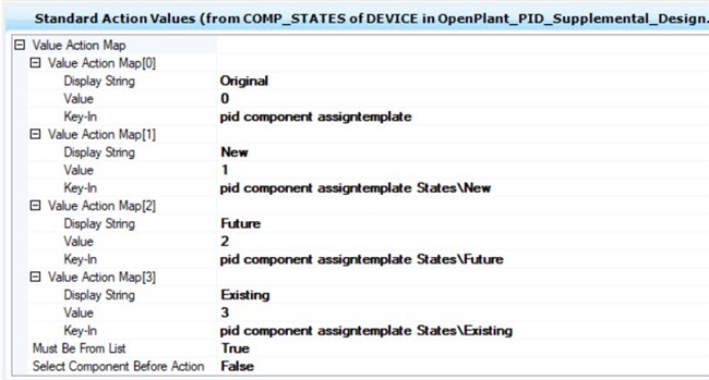

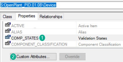

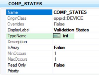

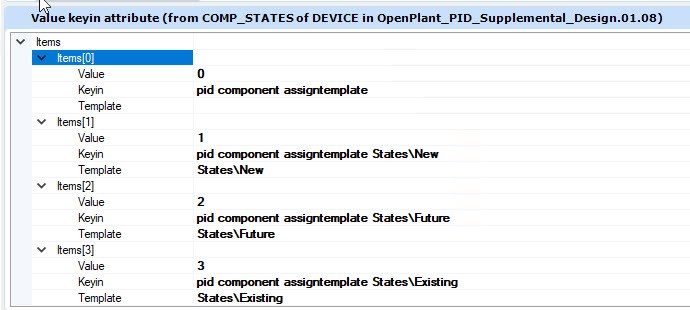

  17. Add a new property as COMP_STATE & enter details as shown below.
  18. Right click on created property & select Custom Attribute to add custom attributes, refer image below.

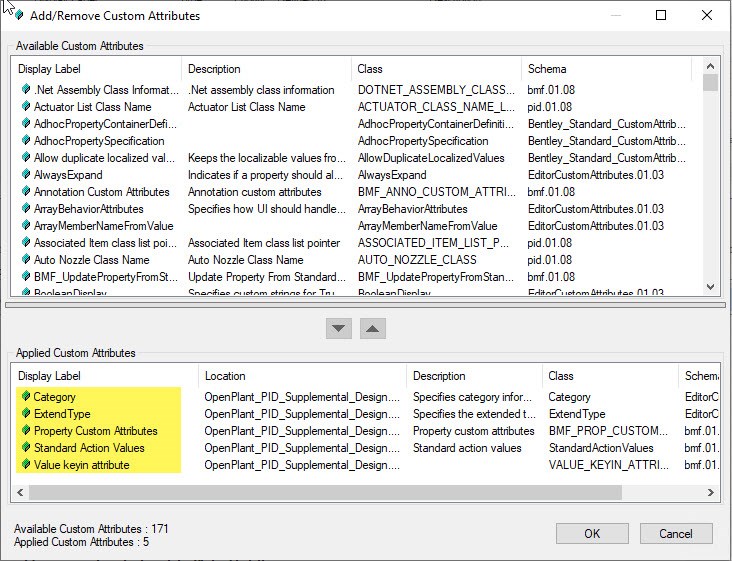

  19. Select Add/Remove to select the custom attributes from the list.
  20. From Add/Remove Custom Attributes dialog, select below mentioned custom attributes from the Available Custom Attribute
    Category
    Extend Type
    Property Custom Attributes
    Standard Action Values
  21. Using drop icon, move this custom attribute under Applied Custom Attributes section. Ensure to change the schema location. Refer sequential steps as shown below.

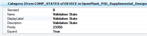

  22. Enter details for applied custom attributes as shown below.
    Display String : Original
    Value : 0
    Key-in : pid component assigntemplate
    Please note: To get the Value Action Map list, right click on Value Action Map & select Add Elements
    ExtendType
    Category
    Value Keyin Attribute

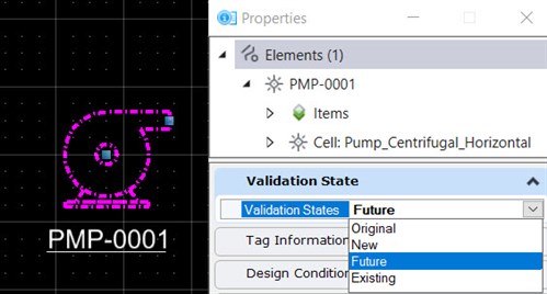

  24. Load OpenPlant PID CONNECT Edition, open a drawing file & perform Properties for any component.
  25. Change the validation state from drop down & notice the symbology change for the component.
