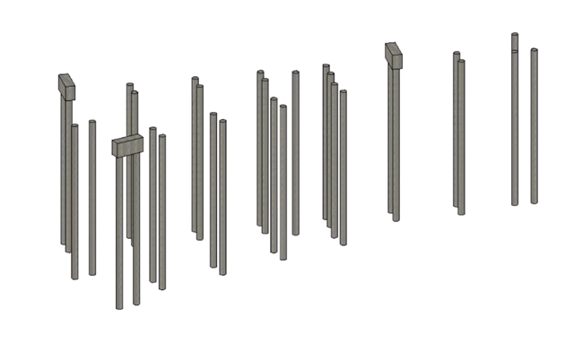

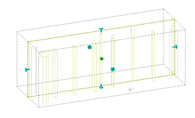

I have modeled columns using "Free Form" tool. Now when I create a Clip Volume, random elements are not visible. Why does OpenBuildings Designer behave this way and how can I fix it?
               THE FREE FORM ELEMENTS IN 3D VIEW                             THE SAME ELEMENTS IN CLIP VOLUME

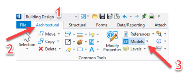

In order to fix the visibility in Clip Volumes or Drawings, follow these steps:
1. From the Common Tools group select Models. You can find it for example in the Building Design Workflow, in the Architectural tab.

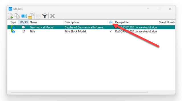

2. Toggle off the "Is Cell" option.
3. Save, close and reopen the file.
4. Create Clip Volume.
Now all elements should be visible, because Drawing Views Levels got added to the model.
