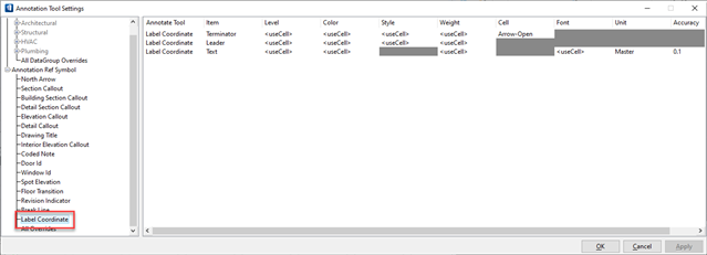

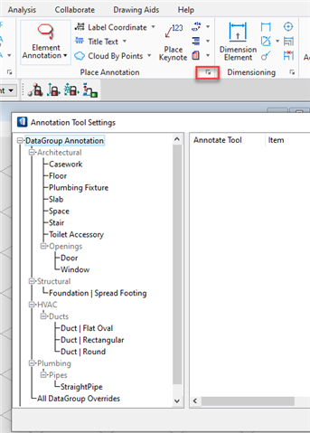

1. Open the Annotation Tool Settings dialog from the Place Annotation quick access button.

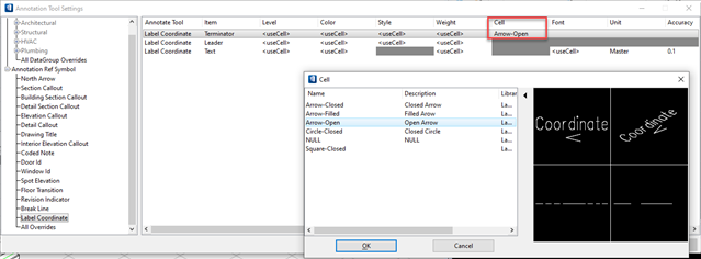

2. Once the dialog is open navigate to Annotation Ref Symbols and under that choose Label Coordinate.
3. Click on the cell option on the right, choose the proper cell from the list, then apply the changes.
4. Click on the Label coordinate tool and you should see that it is now working.
