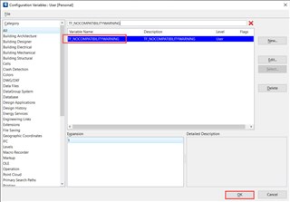

- Open the Configuration Variables dialog box.
- Search for the “TF_NOCOMPATIBILITYWARNING” configuration variable and click on the Edit button.
- When the Edit Configuration Variable dialog box appears enter a new value of “1” and then click OK.
- After that in the Configuration Variables dialog box under TF_NOCOMPATIBILITYWARNING we can see in the expansion the value is set to 1, so again click on OK and restart OpenBuildings Designer.
- Finally, after restarting when you open a file you should no longer see the backward compatibility pop-up.
