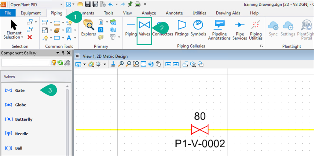

  1. Load OpenPlant PID CONNECT Edition.
  2. Place a Pipeline and place a Valve.

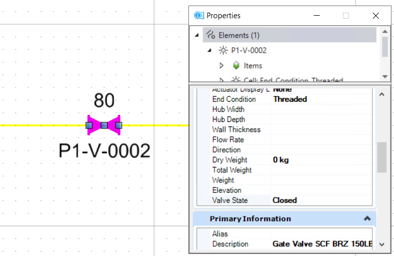

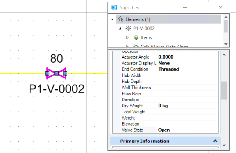

  3. Right Click on Valve and open Properties of the valve.
  4. Change the Valve State as Closed. Notice that the graphics of the Valve also change.

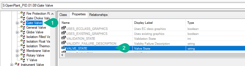

  1. Load Bentley Class Editor V8i.
  2. Load OpenPlant_PID.01.08.ecschema.xml  schema and supplement it with OpenPlant_PID_Supplemental_Design.01.08.ecschema.xml schema.
  3. Navigate to Gate Valve and go to Valve State property. This property is overridden because it was inherited from the Valve class.

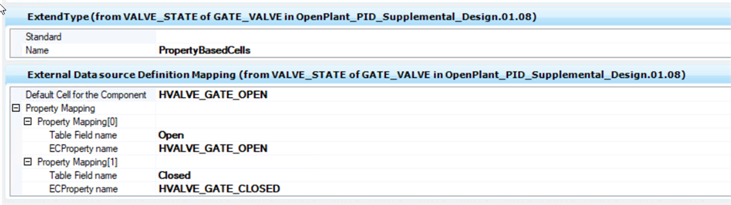

  4. Notice the name of ExtendType. This new attribute implementation is responsible for driving the valve type.
    Note :- For each state, define a different cell name to be used and the software will automatically swap out the cell whenever the state of the valve will change.
