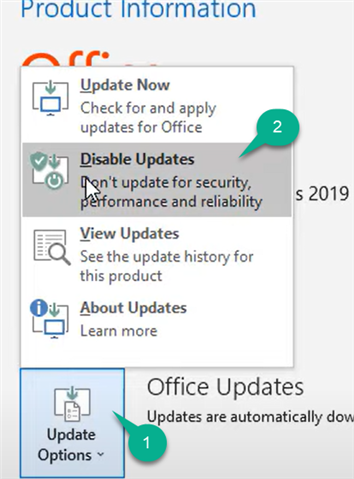

1. Open any installed Office product/program such as Excel and Outlook
2. Go to File > Account/Office Account
3. Select Disable Updates in the Office Updates dropdown

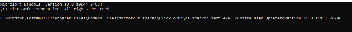

4.Open Command Prompt as an Administrator
5. Enter the following script where you need to specify to the version you want to rollback to (preferable 16.0.14131.20296)
C:\Program Files\Common Files\microsoft shared\ClickToRun\officec2rclient.exe" /update user updatetoversion=16.0.xxxx.yyyy
6. Press Enter
Note: This will then download the older version of Office 365 according to the script you have entered
