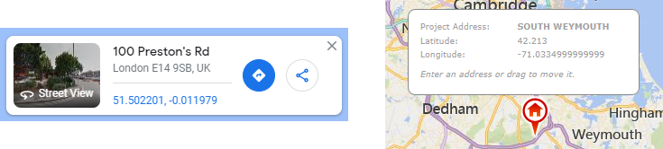

Latitude and Longitude
The first thing to check is the Location and Site setting.
Image 1 - Location marker
Image 2 - Real world location vs model location
Not only can the correct position be used to spatially align iModels, but the correctly set location is also used when exporting to IFC files, helping to fulfil the project requirements.

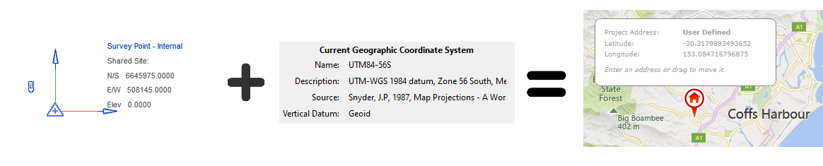

Survey Point
The Revit Survey Point
Image 03 - Revit SP
To check the SP please ensure that it is visible. Visibility settings can be changed in the Visibility / Graphic Override menu.
https://help.autodesk.com/view/RVT/2023/ENU/?guid=GUID-81CB0DD4-DF6E-43A3-AADA-DABC5ED30C6F
"The Revit survey point is a coordinate point that is used to position objects in a Revit model. It is important to understand how the survey point works to create accurate and consistent models.
The survey point has three components:
The origin of the survey point is the point at which all three axes intersect. This point is usually located at the centre of the building site.
When creating a new Revit model, the survey point is automatically placed at the origin. However, the survey point can be moved to any other location in the model. This can be useful if creating a model that is aligned with a specific real-world location.
The survey point is a powerful tool that can be used to create accurate and consistent Revit models. By understanding how the survey point works, it can be used it to improve the quality of the design model."
Considerations
Image 4 - Survey Point
Image 5 - Coordinates converted using a GCS
