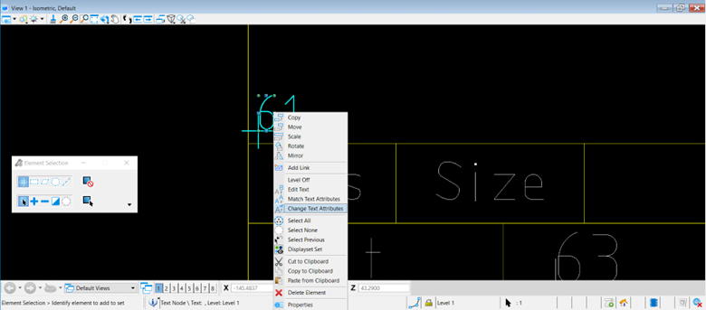

  2. Click on View Attributes and turn on Text Nodes.
  3. Double click on selected Text Node.

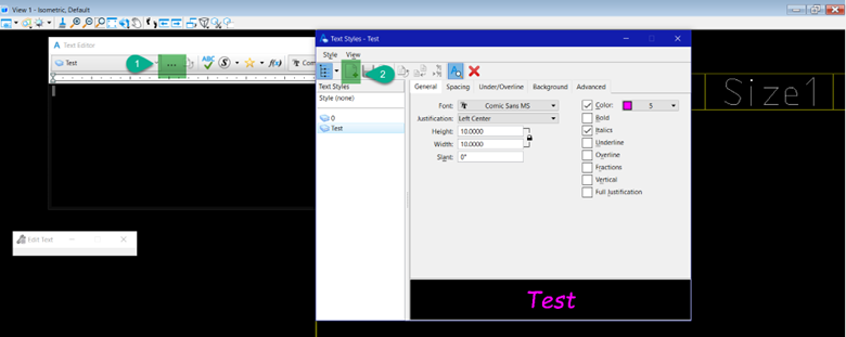

  4. Select Open Text Style Dialogue.
  5. Create new Text Style and put a name (Example: Test).
  6. Input desired font style, height, width, color, and etc.

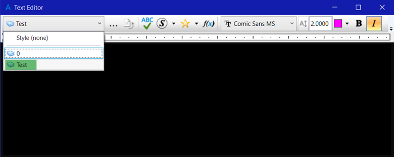

  7. In Text Editor, select Test.

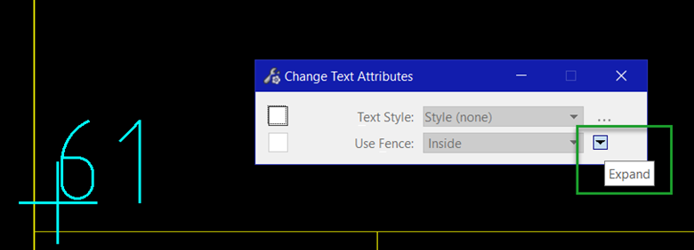

  9. To change the location of Text Node, right on it and select Change Text Attributes.
  10. Click the drop-down to expand the options.

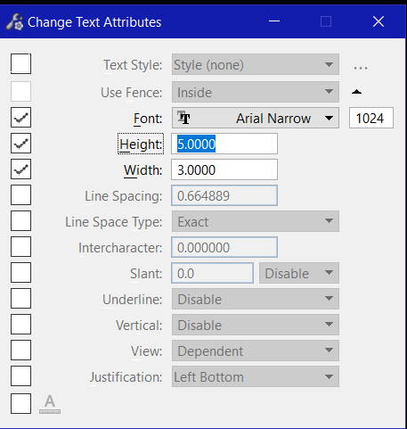

  11. Check the box to enable the property and add values.

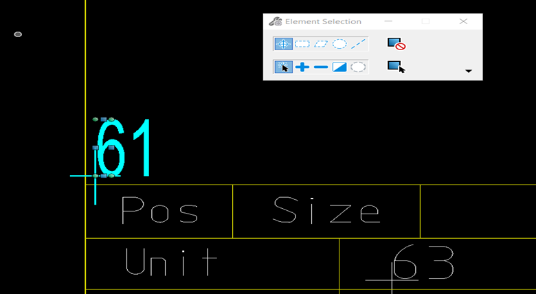

  12. Click on the empty space of seed file to take effect the changes.
