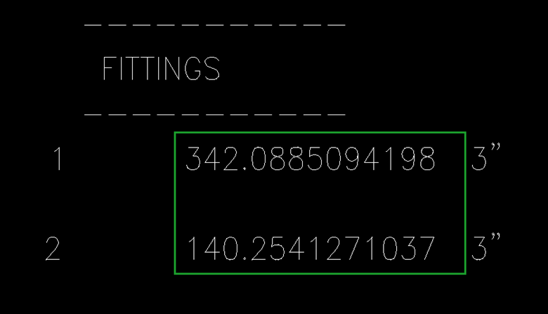

In creating Isometric drawing, user wants to convert or change the numerical value from decimal to feet and inches. It will conserve a space and a clear understanding.
This is the initial value.

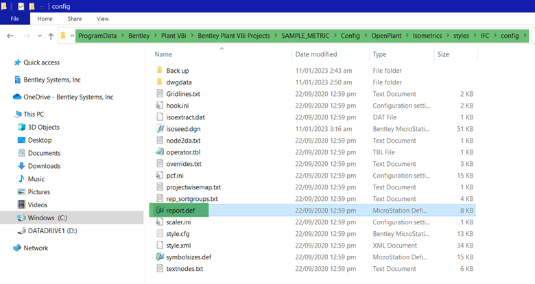

1.  Open report.def file by following the required Root, Project, and Isometric Style.

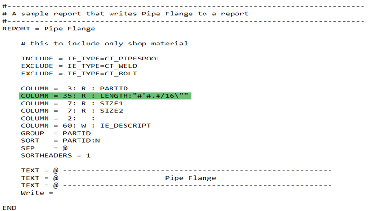

2. Type COLUMN = 35: R : LENGTH:"#'#.#/16\"" in preferred Report.
3. Save and generate Isometrics to verify result.
