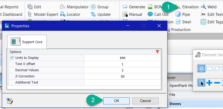

It is necessary to have the elevation/coordinates of pipe support to determine its location and to serve as a guide in on-site installation. This article explains the proper procedure on how to show elevation/coordinates in generated drawing in OpenPlant Support Engineering.
1. Launch OpenPlant Modeler, proceed to Engineered Supports, and use the Elevation command.
2. Select the pipe support and place the coordinates.
3. Generate the drawing.
4. Once again, use the Elevation command and select the center of pipe support.
5. The elevation/coordinates will be visible.
