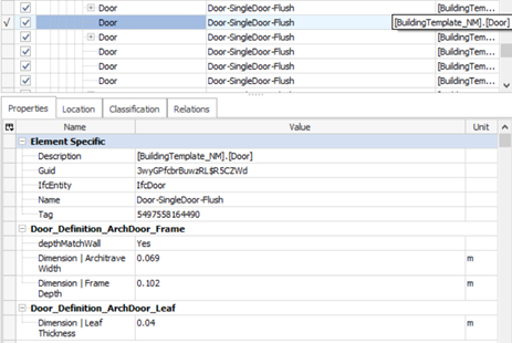

4. If the IFC Exporter can find an appropriate mapping for the iModel components, then elements will be exported to the correct IFC class as per the mapping. This is how it will look in the generated IFC file when you open it in BIMVision which is a free IFC viewer.

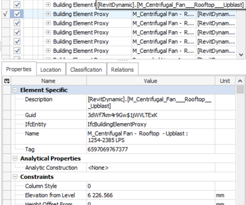

5. But if the IFC Exporter doesn't find the corresponding mapping, then elements will be exported to a "Building Element Proxy" element in the generated IFC file as can be seen in the below image:
6. In the above image you can see that the Exhaust element is being exported as a "Building Element Proxy". The source schema for this element in the iModel is "RevitDynamic" and the ECClass name is "M_Centrifugal_Fan___Rooftop___Upblast". If the user wants to map this ECClass to a proper IFC class instead of just "Building Element Proxy", it can be mapped (as an example) to "IfcElectricAppliance". It will look like the following in the SchemaMapping.json file.

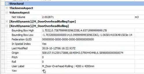

1. Similar to class mapping, we can also add Property mapping in the "SchemaMapping.json" file.
2. Please see the image below. There are different Property Sets and under each Property Set there are multiple properties. e.g. Under the "[RevitDynamic].[M_DoorOverheadingRolling]" property set we have a property called "User Label".
3. Let's say we need that property to be under a different Property Set, then we can add the following mapping to the "SchemaMapping.json" file.
/* Mapping for Coffs_Harbour classes */
    "Class": [ "RevitDynamic", "M_DoorOverheadRolling", "IfcDoor" ],
    "Properties": [
        [ "UserLabel", "NewPropSet", "UserLabel_new" ]

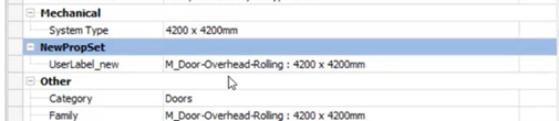

4. The resulting IFC will show you results like this in BIMVision with the modified mapping file.

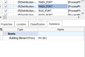

3. If the IFC Exporter can find an appropriate mapping for the iModel components, then elements will be exported to the correct IFC class as per the mapping. This is how it will look in the generated IFC file when you open it in BIMVision which is a free IFC viewer.
Example showing IfcRelNests
The IfcRelAssignsToGroup relationships can be found in the "Objects" tab in the BIMVision

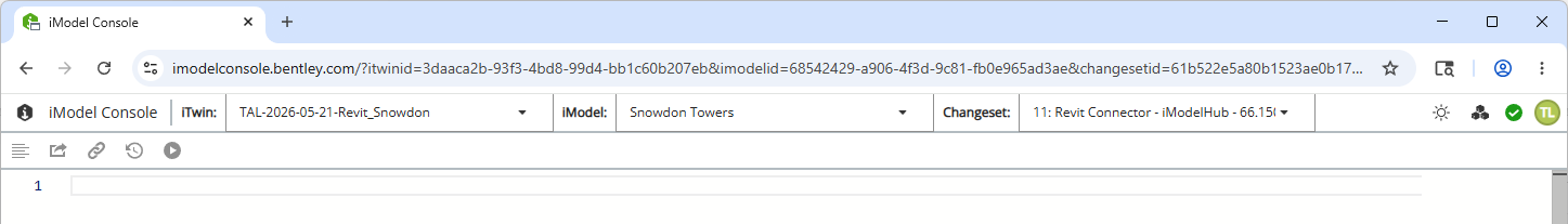

4. Specific relationships that can be mapped to IFC may need to come from the specific content of your iModel. To  view the existing relationships that are in your iModel, use the schema editor. Accessing the schema editor is easiest the first time if you first open the iModel Console application and navigate to your iTwin, your iModel and finally to the most recent change set.
After each selection of iTwin, iModel or Changset, there will be a delay while that is opened and there will be a spinning circle at the top right side of the iModel Console during that time:
Once the circle becomes a green checkmark, you will be able to continue.
Once you have selected your iTwin, iModel and Changeset, you can  open the Schema editor to view the relationships contained in your iModel. Click on the schema editor icon to the left of the green check box:

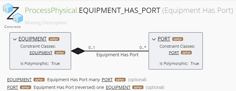

and under relationships, you can find DEVICE_HAS_PORT and EQUIPMENT_HAS_PORT
Click on that brings up this information:
This tells you that the schema this is coming from is "ProcessPhysical" and the relationship name is "EQUIPMENT_HAS_PORT". You will also need to determine the relationship type as explained above.

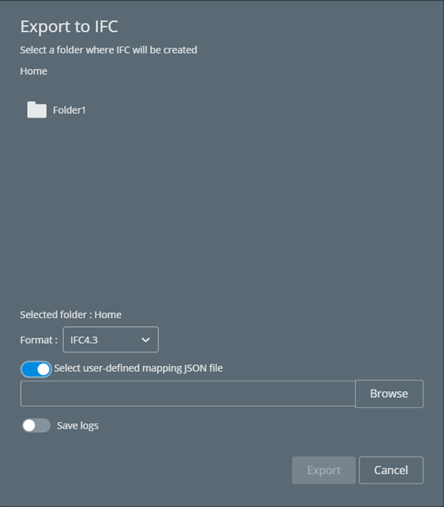

Using a custom mapping file
In order to use your modified SchemaMapping.json, you will need to provide it to the IFC Exporter. If you are using itwin.bentley.com you first need to store the modified mapping file somewhere on share for this iTwin. When the Export to IFC interface appears, enable "Select user-defined mapping JSON file" and then browse to your mapping file on share.
