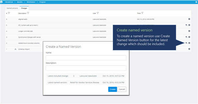

Creating a named version
Follow these steps to create a named version:
  1. Go to iModel Changes Tab
  2. Find the last required change in the timeline
    NOTE: The list of changes included in named version cannot be changed after its creation.
  3. Select Create Named Version button
    NOTE: You need to have Manage iModel Versions permission.
  4. In Create a Named Version dialog add a name (required) and description (optional)
    NOTE: you can see which change is the last included from the timeline as well as what is the name of previously created named version.
  5. Click Create
After creating named version, you will be taken to iModel Named versions tab. If needed you can edit named version name or description using Update action item.

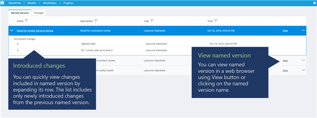

Viewing a named version

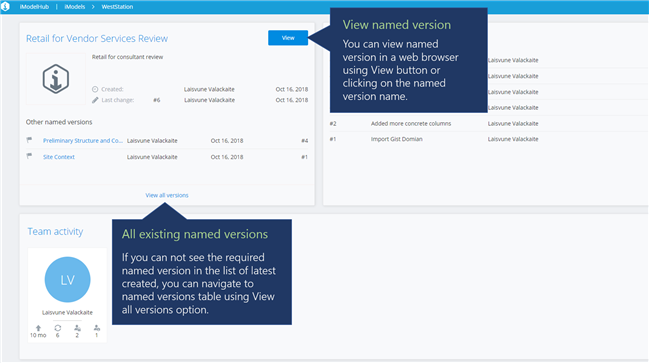

Once you have created a named version, we will automatically start enabling it to be web viewed. Use View action near required named version, as well as named version name to open Design Review application.
Viewing a named versionĀ inĀ the Summary page:
Viewing a named version in Named versions tab in the Progress page:

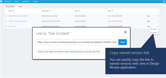

Sharing a link to named version
If you want to share named version view link with others, there are few easy ways how to achieve that:
