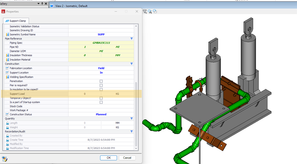

The purpose of this document is to provide instructions on how to add a property on a class of an OPSE component
1. Launch OPSE and select workspace-workset
2. Select Project Dashboard tool
3. Under the Administration, select Class Browser. Add a property entry in the class. Take note of the specific columns.
5. Relaunch OPSE and put a new support to verify the changes.
