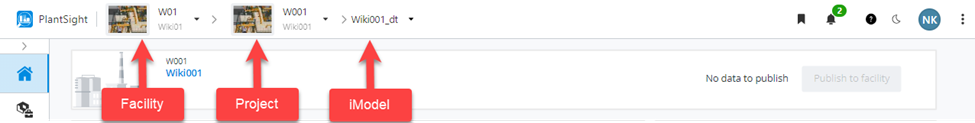

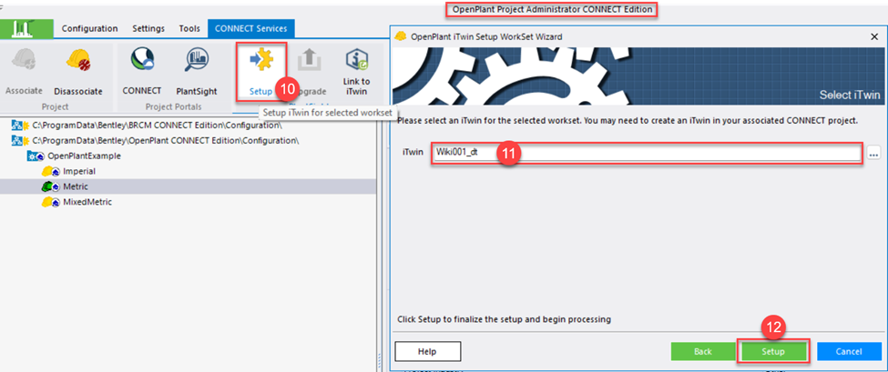

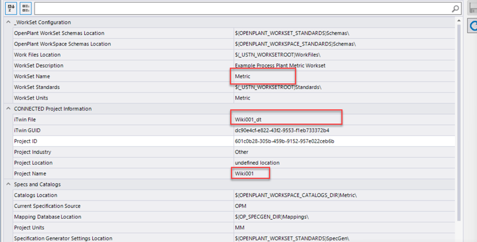

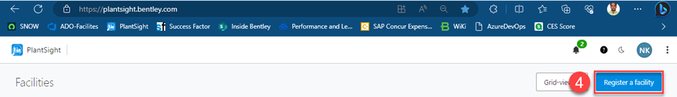

This wiki will help us to understand how we can setup OPPID, OPM & Plantsight in connected environment so that we can push and pull information from one product to other.
Prerequisite-
Install - OpenPlantProject Administrator
OpenPlant PID
OpenPlant Modeler
Access to- Plantsight

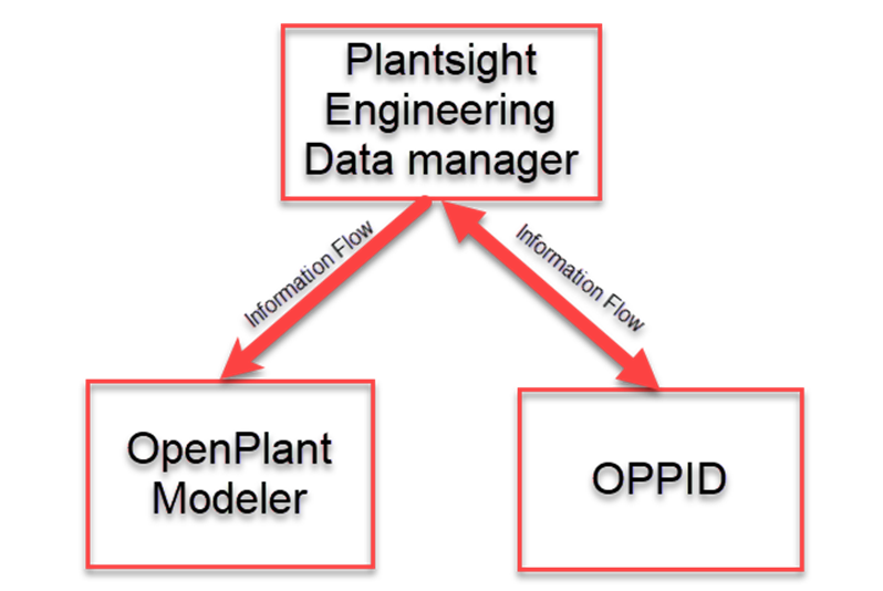

Case 1
In this case Information is first Created in EDM and then pushed to OPM & OPPID, if some changes are made in OPPID it can be synced to EDM.
Case 2
In this case Information is generated in OPPID and then pushed to EDM and OPM.
