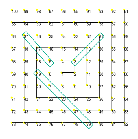

Prime numbers never fail to amaze us. One example of this would be the Ulam Spiral. If we have a rectangular spiral where each point represents a number. The starting point denotes 1 and the next point is 2 and so on so for as the spiral proceeds. We would find that some set of prime numbers line up in a series of straight lines. If we only display the points that represent the prime numbers we can notice an amazing pattern emerging out.

Create the required set of points for constructing the rectangular spiral. This is done using by function techniques of point node.

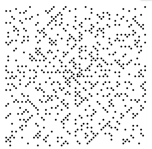

Once we have the point set for the rectangular spiral, we can further modify its script to only display the points that represent prime numbers. This could be done with an if statement which will check a condition before creating each point. Here the condition would be to check before creating the nth point if n exists in the previously created prime number list. In this way, we can get the Ulam's spiral from the rectangular spiral.

Ulam's Spiral of 669 Prime Numbers

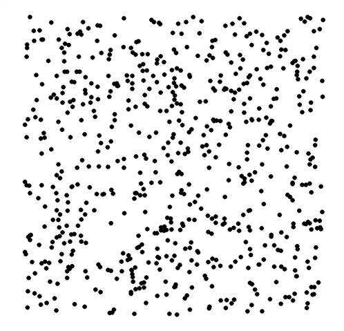

669 Random Points
                  Just 669 Random Points
