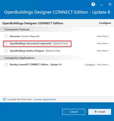

- For New installations: When installing OpenBuildings Designer (Or any Open Application) On the landing page of the install dialog, under Companion features, there is a check box for OpenBuildings GenerativeComponents.
