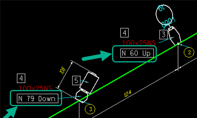

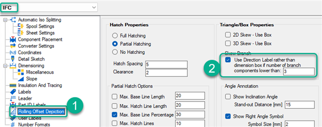

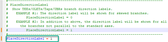

This document explains the procedure to display Orientation label for the olets coming out of header branch.
