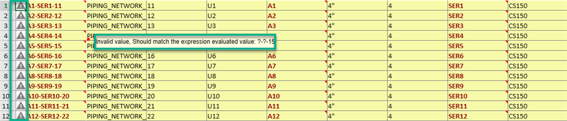

Importing the tag data in EDM in the excel format through the error as "Invalid Value" in Piping Network System as shown in the image.

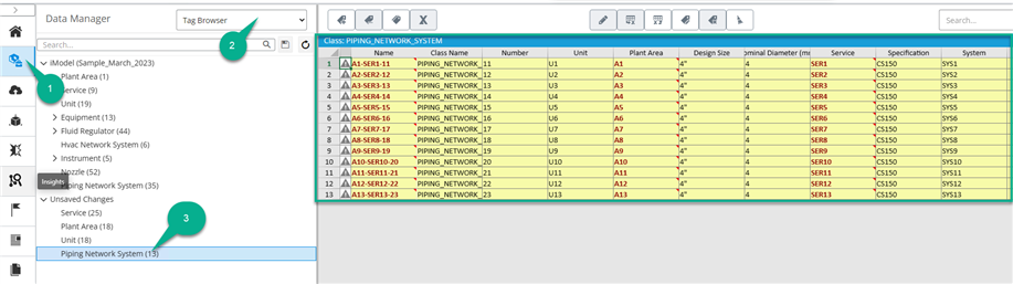

  1. Launch EDM in the PlantSight

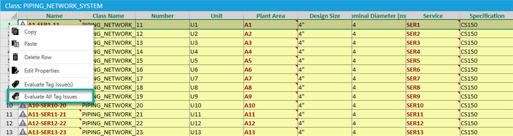

  2. Navigate to the Piping Network System under tag browser of Unsaved changes.
  3. Select the First row and click on Evaluate all tags issues. It will evaluate all the tags in bulk.
    After evaluating click on save.
