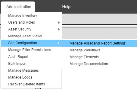

A) Go to Site Configuration > Manage Asset and Report Settings

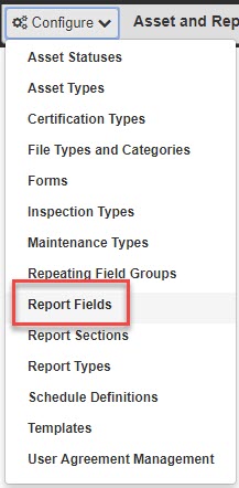

From the forms designer, select Report Fields

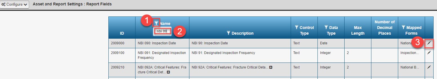

By selecting the filter for the form name, limitation of the two specific fields related to NBI 90 & NBI 91 are found much more simply
1) select the filter
2) type in NBI and the beginning number of the field (i.e. NBI 09)
3) select the pencil to edit the field

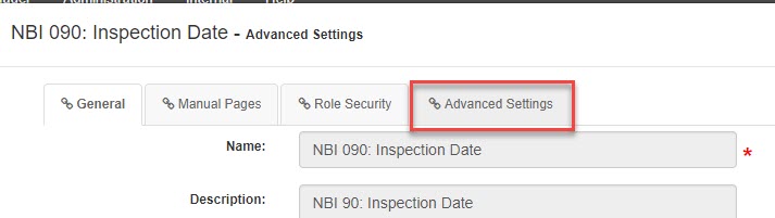

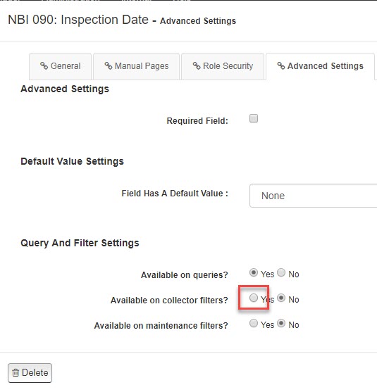

Select Advanced Settings
Toggle to add NBI 90 to be available on report filters

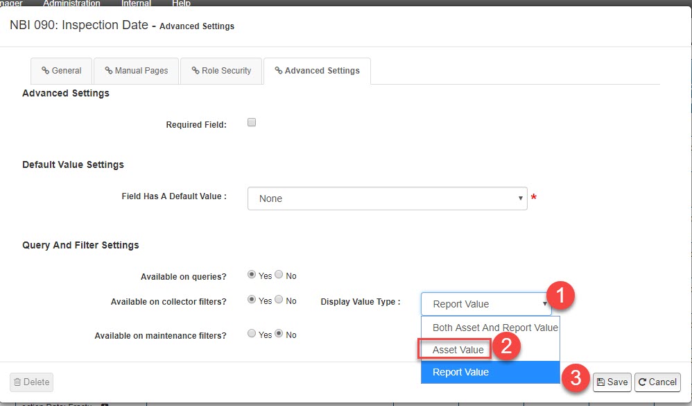

Use the  dropdown (1) to select Asset Values (2)     **rationale behind Asset Values - report values are only displayed while a report is in progress, not before it is created, or after it is approved**
and Save (3)
   Repeat the process to do the same for NBI 91 (or other fields as required for Underwater, Fracture Critical, etc)
