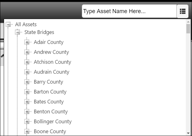

Now, view the assets available to you in the Asset Tree:
The assets you see are determined by your user group(s). Your administrator creates the user groups and adds the necessary users, then sets up the user group security by making specific assets available to each of the user groups.

The fact that you can view 00001 in the Asset Tree and access its information means that the administrator has added you to at least one user group with access to the asset.
