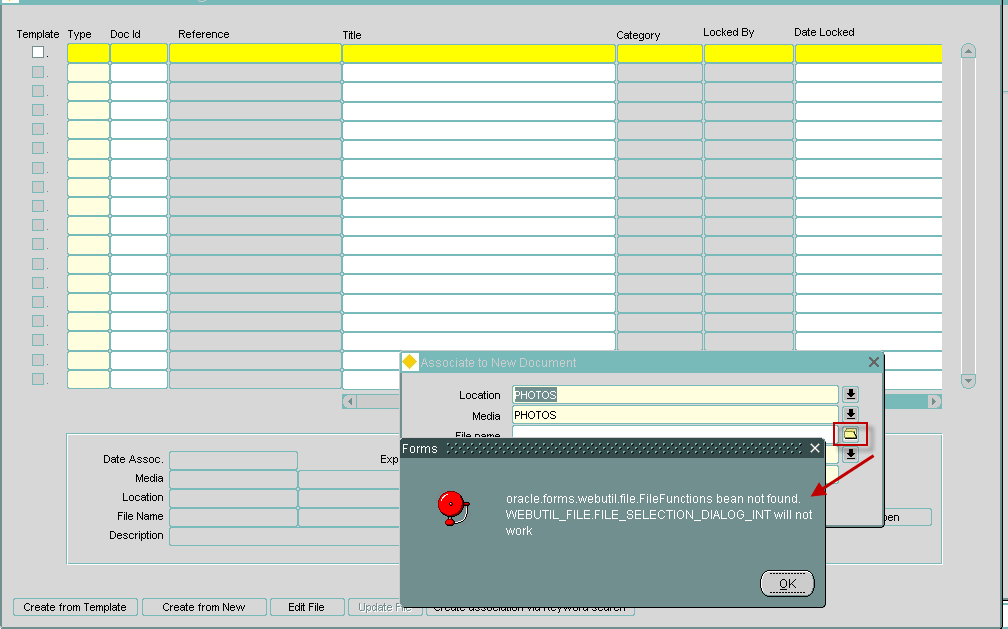

Explanation
A user can’t attach a new document and after pressing folder button the error message
Oracle.forms.webutil.file.FileFunctions bean not found. WebUTIL_FILE.FILE_SECTION_DIALOG_INT will not work
appears in Associate Documents form.

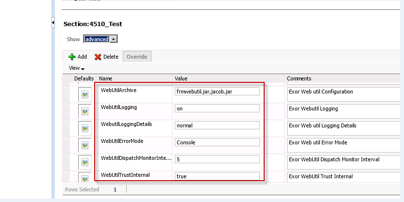

How to Avoid
This error message raises because WEBUTIL component wasn’t installed or configured. Please check
1. frmwebutil.jar and jacob.jar present in the folder < ORACLE_MIDDLEWARE_HOME>\forms\java
2. and jacob.dll was copied to folder < ORACLE_MIDDLEWARE_HOME\ >\forms\webutil
3. the default section of formsweb.cfg must have option's set as below
WebUtilArchive frmwebutil.jar, jacob.jar
WebUtilLogging on
WebUtilLoggingDetail normal
WebUtilErrorMode console
WebUtilDispatchMonitorInterval 5
WebUtilTrustInternal true
4. CLASSPATH (default.env) must contain path for the Jacob.jar
