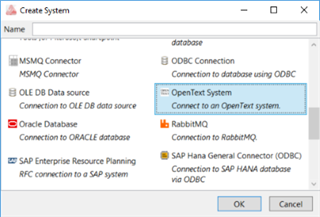

  1. Installation of standard BECS package
  2. After installation (if standard package does not include OpenText Connector), is necessary copy dll file “Ace.Integrator.OpenText.dll” to BECS installation path.
  3. After installation (if standard package does not include OpenText Connector), is necessary copy dll file “Ace.Integrator.OpenText.dll” to BECS Visual Architect installation path (Architect\Extensions\Application).
  4. Product will be after Activation ready to use.
