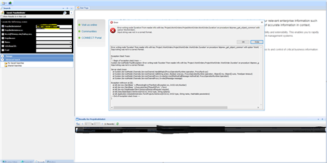

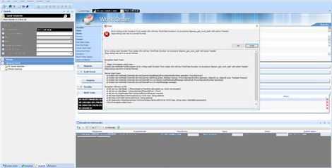

When using eb Director, user faces multiple error message regarding duration when searching and browsing for Project activities and Work Steps.
If the Duration set to NULL in the tables work_steps, work_orders able to browse the items in eb Director. But duration (any value besides NULL) get the same error again.
The error message as follows of Project activity or in Work Order.
 Project Activity Error
Work Order
This is because of Regional Format Configuration settings, Different region setting uses different Decimal Separator. For this we have to need to change the decimal and digital grouping symbol.
