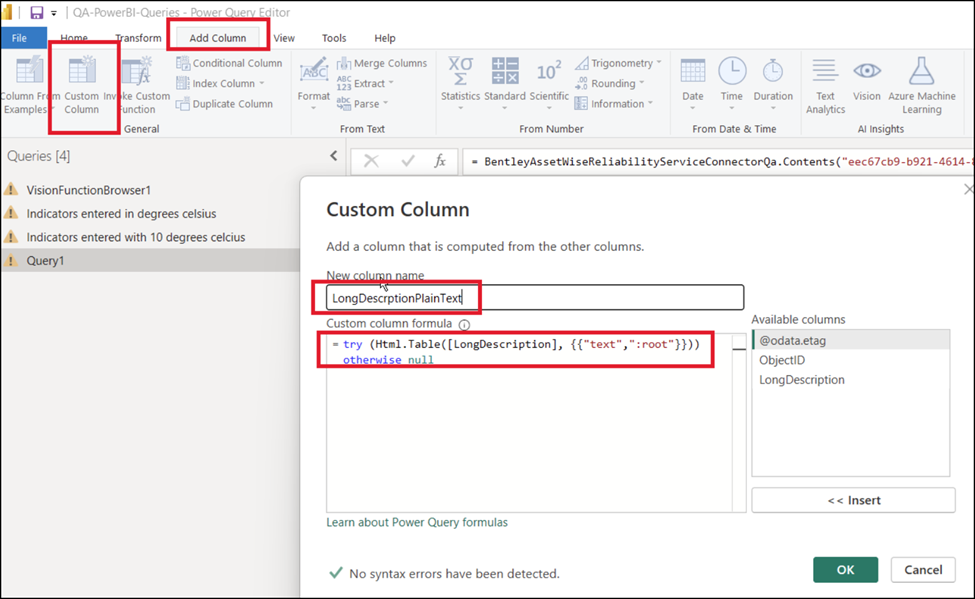

  1. In the Power Query Editor window, select the Add Column
  2. Click Custom Column to open the Custom Column dialog.
  3. Give the column a name, for example, “LongDescriptionPlainText”.
  4. Enter the following formula:
try (Html.Table([LongDescription], {{"text",":root"}})) otherwise null

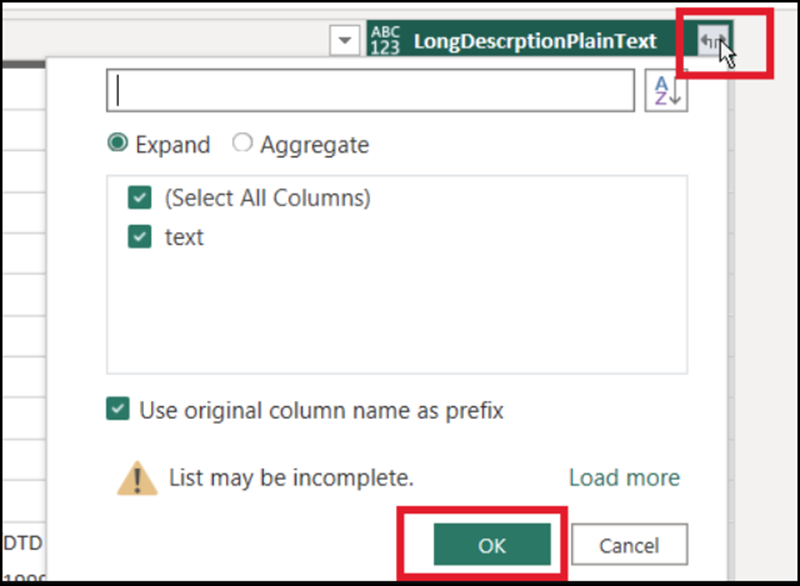

  1. Click OK.
  2. Expand the new column and click OK.
