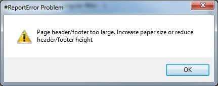

FlowMaster does not have report options like other OpenFlows products, however it does allow header/footer data to be input under Files > Properties.
A user is allowed to select a company logo in the properties. This error message was caused by the logo being too large for the paper size selected. For a letter size sheet of paper, the user needs to scale down the logo to fit with the other information into a 1.45" bottom margin.
