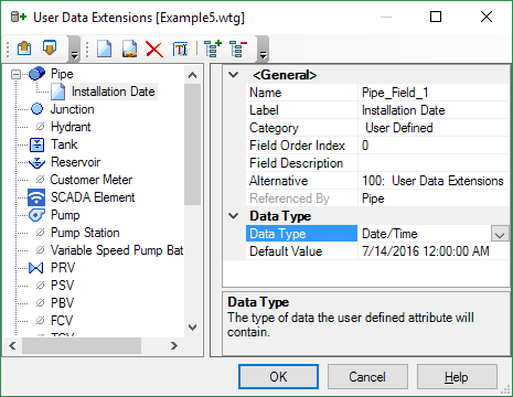

2) Use the User Data Extensions tool to create a new field for your pipes, with the format set to Date/Time, then import the installation date into that field with Modelbuilder.
