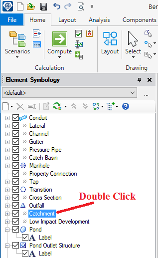

How do I adjust the transparency of polygon elements like catchments or Low Impact Development Controls (LID)?
Double click on Catchment (or LID) in Element Symbology:
In the properties window, change the transparency setting:
