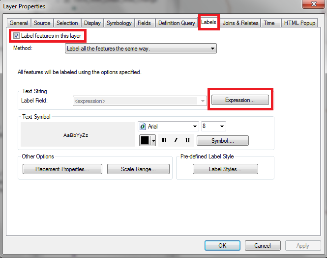

3) Right click on the pipe layer and go to "Properties". Click on the Labels tab and click the "Expression..." button.

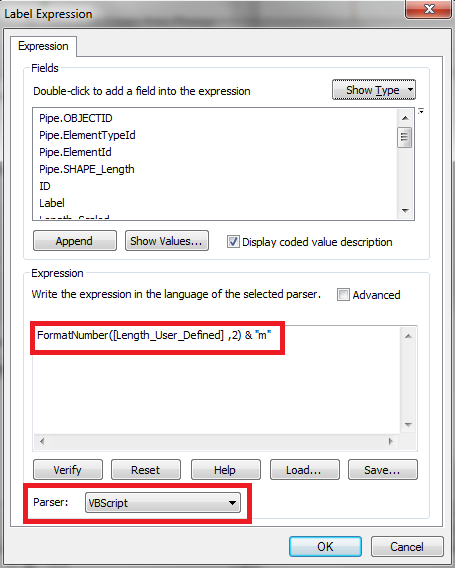

Make sure the parser for the expression is set to VBScript and enter this in the dialog box above the parser setting:
FormatNumber([Length_User_Defined] ,2) & "m"   the "[Length_User_Defined]" field can be replaced by any field you like, such as flow or diameter. Just make sure to double click it from the fields like above expression to add it in. The number after the comma in the expression is the number of decimal places that you want to be displayed. Finally, the & "m" adds whatever string is in the quotation marks  to the end of the expression.

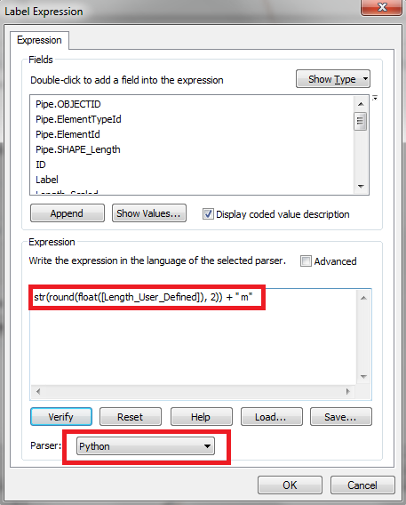

Another way to accomplish the same task is to remove the comma's before the thousands place and use a Python parser with the expression:
str(round(float([Length_User_Defined]), 2)) + "m"
