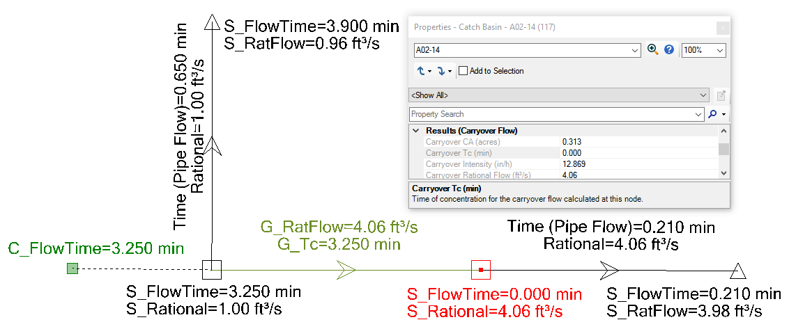

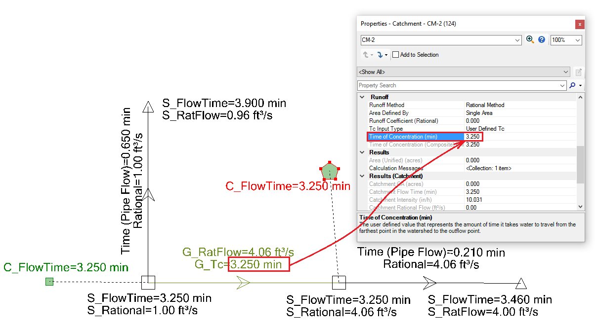

If you'd like to see the 'carryover Tc' value in the catchment that is not displaying it, a workaround would be to attach a small catchment (for example zero or 0.01 acres) with a Tc equal to the value you want to use to compute carryover.
For example, here is a model that does not apply a Carryover Tc to the catch basin downstream of a gutter:
Here is the same model with the workaround (explained above) applied.
