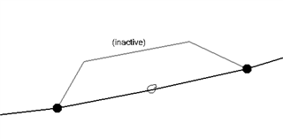

The pump element can be used to model a booster pump; there is no difference in the data input. booster pump data can be entered for head and flow in the pump curve data and then numerical solver will calculate operating point of the booster pump based on system conditions. If required necessary controls can be added to turn the pump on and off.

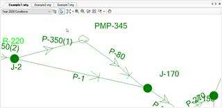

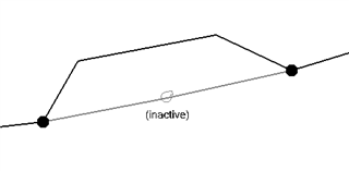

If you want to model a bypass pipe for the condition when booster pump is off (to allow flow through), that can be modeled either with a check valve on a bypass pipe going around the pipe as shown below or with controls on that bypass pipes as required. The check valve would be oriented such that when the pump is on, it is closed, and when the pump is off, it is open.
Scenario with booster pump
Scenario without booster pump
Check valve on pipe
If flow does not need to pass through the pump in scenarios where the pump is not in place, you can add the booster pump in the base scenario and change its "status (Initial)" to OFF in the other scenarios.
