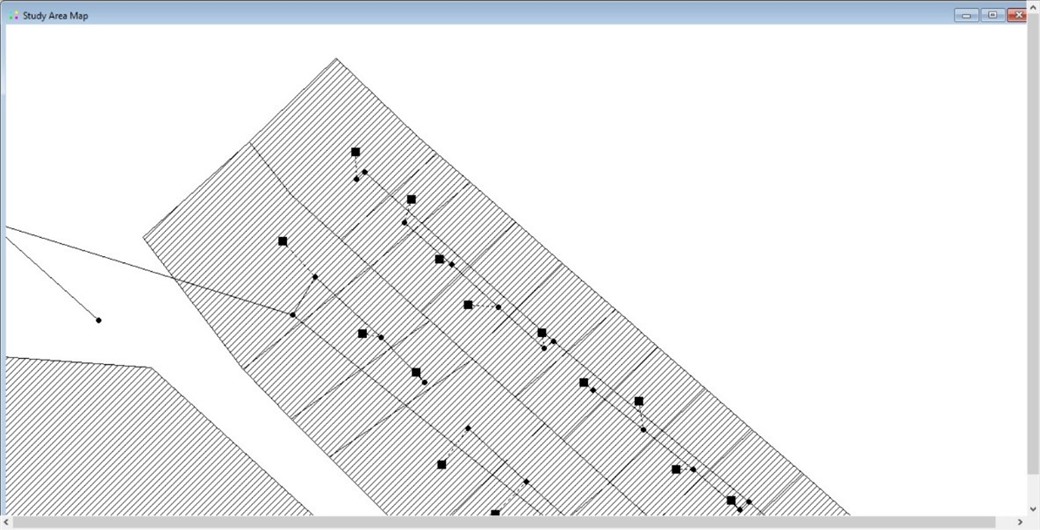

The model exported from InfoSWMM, when opened in EPA-SWMM would look like this;
The grey shaded areas are the catchments with the black box shaped catch-basins.

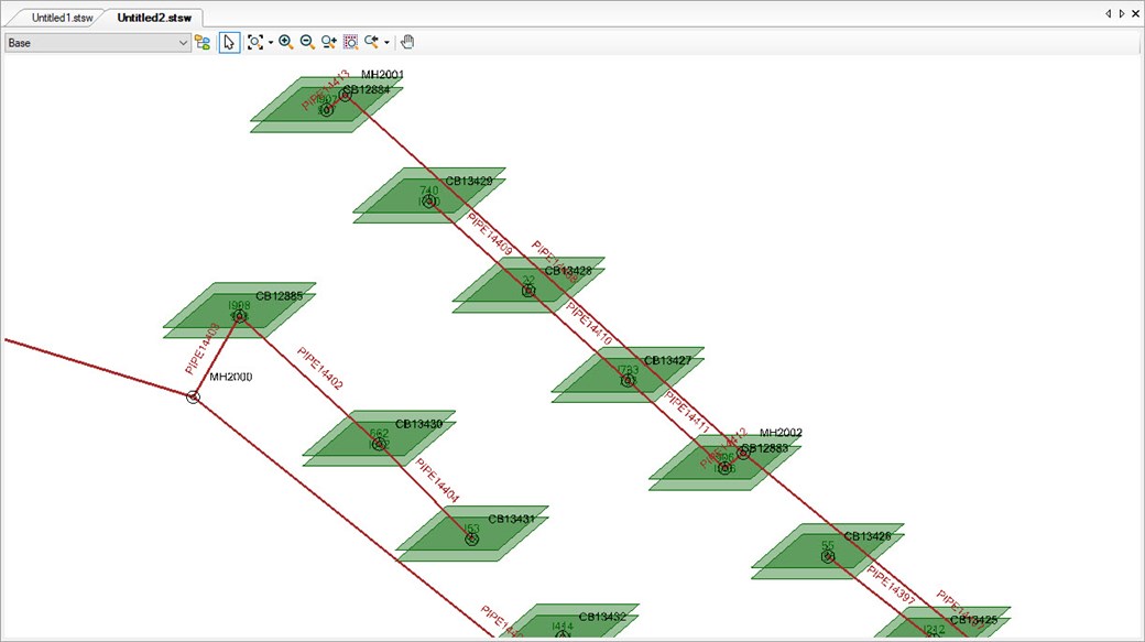

When this model (.inp) file is directly imported in SewerGEMS or CivilStorm (File > Import > SWMM v5) then the model appears like this;
As seen, the geometry of the catchments is lost. However, the parameters defining the catchment such as area (if user defined), SWMM properties etc. would be imported and assigned to the respective catchments.

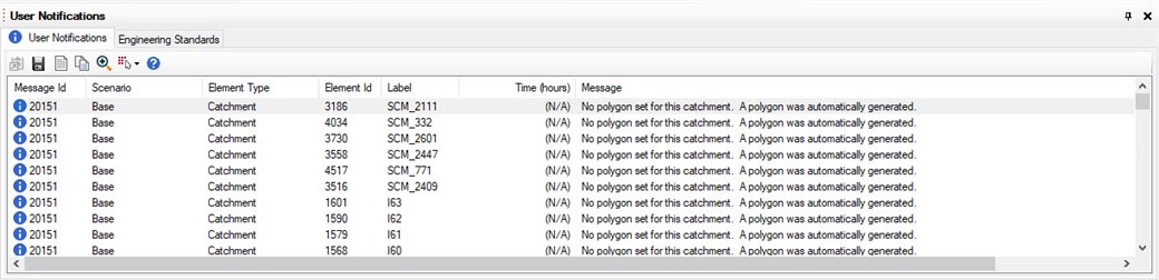

Along with the catchments losing their geometry a user notification also appears informing that the geometry is missing, and a default polygon shape will be assigned.

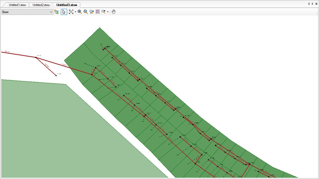

When the new .inp file is imported, with the corrected geometry of the catchments, the model would appear as below when imported in SewerGEMS or CivilStorm;
From the above image it can be seen that the catchment geometry is now corrected.
