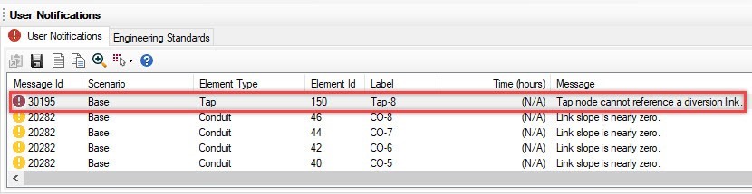

When validating a model where a property connection element is connected to a diversion link the following user notification occurs;
Tap node cannot reference a diversion link
This “red” user notification is generated when a property connection is connected to a conduit which is set as a diversion link via a tap node. The message would look like this;

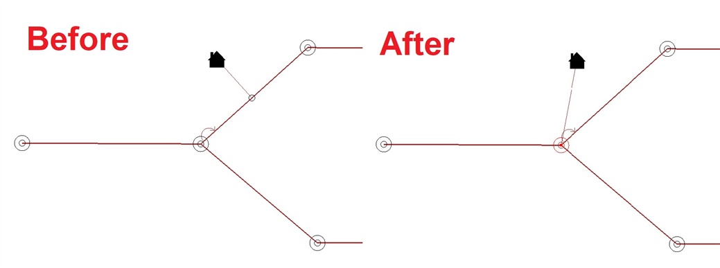

Option 1: Assign the Property Connection to the upstream node
This can be done by manually deleting the tap and lateral for the property connection and assigning the property connection to the upstream node. You can also right click on the end of the lateral link, choose "reconnect", and attach it to the manhole.

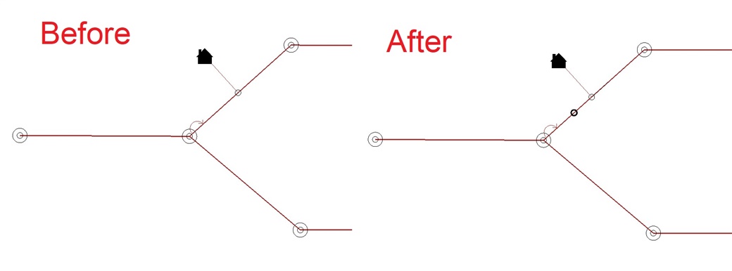

Option 2: Assign a transition
With this option you can simply divide the conduit by a transition element. After doing this, check the new downstream conduit and ensure that “False” is selected for the “Is Diversion Link?” property.
