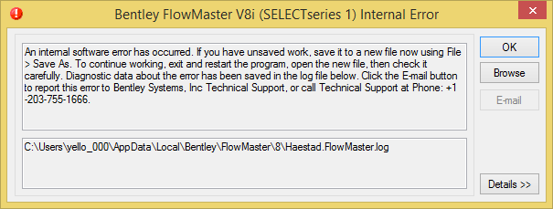

When opening FlowMaster V8i SelectSeries 1 the software appears to open, but just hangs and needs to be closed using the task manager.
This issue is primarily seen when using Windows 8 operating system. When FlowMaster is opened using Windows 8 a message may display stating "An internal software error has occurred" as shown below.
Reason
This issue may be related to a corruption in the engineering libraries.
