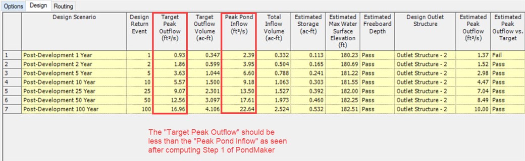

When trying to compute PondMaker step 2, the following user notification appears:
"The target peak X ft³/s is greater than the inflow hydrograph peak flow, Y ft³/s. You must specify a target at or below the peak flow of the inflow hydrograph."
This message occurs when the postdevelopment peak flow is greater than the predevelopment target peak flow. In short, it indicates that a pond is not needed to attenuate the postdevelopment inflow because is is already lower than predevelopment conditions.
The idea behind PondMaker is the design a pond to attenuate the postdevelopment peak to be equal to or less than the predevelopment peak conditions. Normally after development, the land is less porous and the peak flow is higher.
If you believe that these flow values are correct, and the decrease is due to some undetained (bypassed) flow that needs to be compensated for, see: Accounting for bypassed (undetained) flow in PondMaker
If you believe that these flow values are not correct, you can "fix" this by adjusting the conditions so that the postdevelopment peak is greater than the predevelopment target peak:
