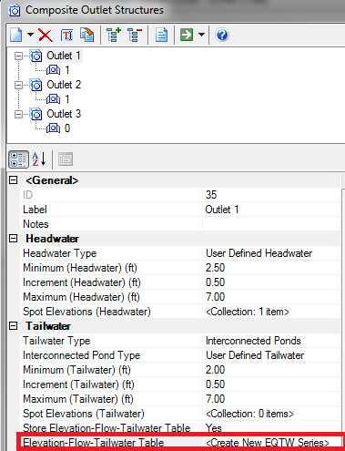

1) Go to Components > Composite Outlet Structures and create your composite outlet structure. A tailwater type of "Interconnected ponds" must be selected to use EQTW curves.
2) Click the name of your composite outlet structure and choose "Yes" for the "Store Elevation-Flow-Tailwater table?" property.
3) Select "Create new EQTW series" for the "Elevation-Flow-Tailwater" field.
4) Compute the EQTW rating curve by clicking the green compute arrow at the top. After calculation, the EQTW table will be stored in the Elevation-Flow-Tailwater manager.

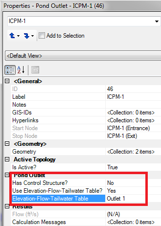

5) Close the Composite Outlet Structure manager and look at the properties of your pond outlet link.
6) Select "No" for the "Has control structure?" field, "Yes" for "Use Elevation-Flow-Tailwater Table?" and select the EQTW table entry from the "Elevation-Flow-Tailwater Table" field. Now when you compute your model, it will use the stored EQTW table instead of recalculating it.
