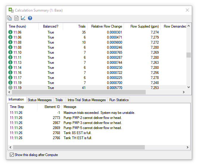

When computing a model a warning user notification appears stating:
"The maximum number of user notifications (1000) was reached."
How to display the user notifications that are not showing because of the 1000 message limitation.
It is best to try addressing some of the notifications first (some may be related to a single problem), then try again. Use the Validate command first before computing the model.
For WaterCAD, WaterGEMS and HAMMER, under Calculation Summary, click on each time step to see user notifications associated with that time step:

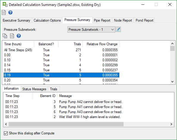

For SewerCAD (or the GVF-Convex solver in SewerGEMS), click the "Pressure Summary" tab of the calculation summary, select a pressure subnetwork, then click through the timesteps:

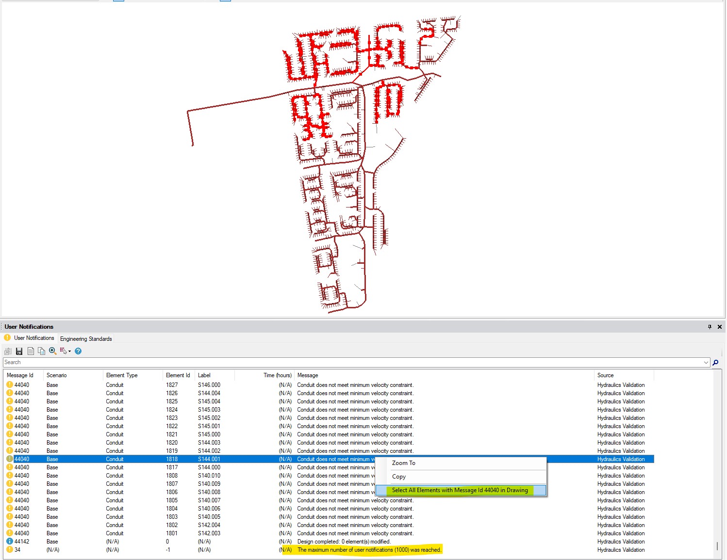

Note: If you receive the "The maximum number of user notifications (1,000) has been reached" message, when selecting elements within a notification, only the elements included in the 1,000-notification list will be selected (see the screenshot below). This means that some elements facing the same notification issue might not be selected due to the fact they are not included in the notification list.
