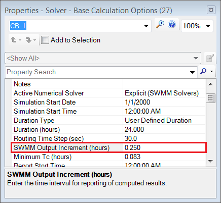

How can I enter the time interval for reporting of computed results (ie. output increment) when using the SWMM (Explicit Solver)?
This can be set by going to Analysis > Calculation Options.
Double click on the calculation options you are using to open the properties dialog.
This time can be set in the field "SWMM Output Increment".
Note: The field name may be different for other solvers.
