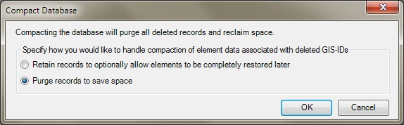

  2. Go to Tools > Database Utilities > Compact Database.
        Note: For the CONNECT Edition series products, this can be found under File > Database Utilities > Compact Database.
  1. Select the database file associated with the model and select Open.
  2. A new dialog will be generated. Select the option to purge the database to save space. (see below snapshot for details)
  3. Once this is completed. Reopen the model and compute it. The error message should no longer occur.

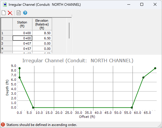

D) This may be related to using an irregular cross section for a conduit or channel, but with an invalid station vs. elevation curve. Open the "collection" for the Irregular Channel Section property and look for any red messages.
In the example below there are two Stations with the same value (0+00), which could be fixed by changing the second one to a "1" (0+01). This should be fixed in a future version (reference #1554725)
