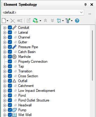

Option 1
Open Element Symbology (View > Symbology) and make sure the checkbox next to the missing element type is checked. If it is not, it will not be displayed in the drawing. By putting a checkmark in the box, the element should be displayed.
If you have color coding, also make sure that the color used does not match the background layer.

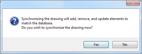

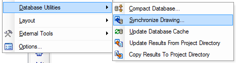

In order to synchronize the modeling data and the drawing. For CONNECT Edition and later, go to File > Database Utilities > Synchronize Drawing. For V8i go to Tools > Database Utilities > Synchronize Drawing.
When prompted, click Yes.

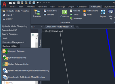

In AutoCAD integrated mode, this is located under the WaterGEMS ribbon > Hydraulic Model > Database Utilities:

1) With all models closed and the program itself open. For CONNECT Edition and later, go to File > Database Utilities > Compact DatabaseFor V8i go to Tools > Database Utilities > Compact Database
2) Choose the model's database file
3)  Select the option to purge the database to save space
4)  Open the model and go to Tools/File > Database Utilities > Synchronize Drawing.
This should update the drawing so that any elements that should be in the model appear in the drawing.
