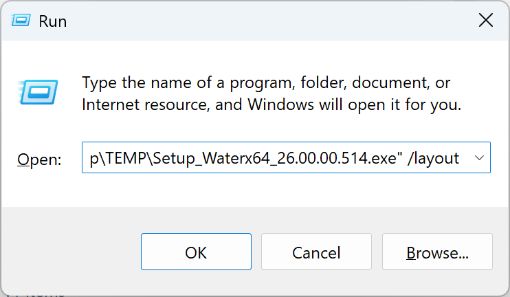

Deployment Images (2025 onward)
Deployment images are created using the /layout switch when running the executable, for OpenFlows Water/Storm/Sewer version 2026 and greater, and FlowMaster version 2025 and greater. This facilitates both the silent aspect ("No UI mode"), as well as customized installation options such as the path, which specific products to install, whether or not to integrate with other applications, and other options. Additionally, deployment images will download all the needed components, creating an offline installer which does not require internet (normally starting with version 2026, the executable files from the Software Downloads site are just small online installers which download the information during installation)
IMPORTANT: there is a known issue in version 26.00.00.508 and 26.00.00.513 causing the deployment image to not include the selected applications. This has been fixed in version 26.00.00.514.
As an administrator, you can run the installation file with the /layout syntax (from the Windows Run window for example) and step through the process - it will look like you are installing but you will actually be configuring the settings that will be used when the deployment image is later run on the end user computers. Choose the desired options including the installation path and which products will be installed.
For example you may only want to deploy WaterGEMS (silently) without integrating with AutoCAD. So, you would use the /layout syntax against the OpenFlows Water installer, choosing "No UI", choosing only WaterGEMS and unchecking the AutoCAD integration option. This creates a .lyt file - when present next to your installation executable, it will automatically find and use it to apply the desired deployment settings.
Note: after you configure the deployment image, it will download all the necessary files, creating an offline installer that does not require internet.

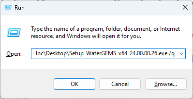

Silent Mode syntax for older versions (before 2025)
The following is an example syntax to silently deploy WaterGEMS 2024, without any options added (see further below for additional options)
Setup_WaterGEMS_x64_24.00.00.26.exe /q

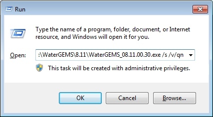

Versions using IExpress and Wix Technology (~2010-2013)
Recent versions of OpenFlows products (as of ~2010-2013) utilize IEpress to extract the installation files and Wix to package the .msi. Versions using this technology can be silently installed by running the install file with the either the /gm2 /ai or the /q:a switch, depending on the version. See the table above for the syntax needed.
A server script would need to execute this on the client computerO, with the install file in a shared/network location. Two exceptions are version 08.11.02.31 of WaterCAD, WaterGEMS and HAMMER, and version 08.11.01.51 of PondPack (see "older IEpress/Wix" section below for these).
When run, the program will attempt to install without any user interaction.

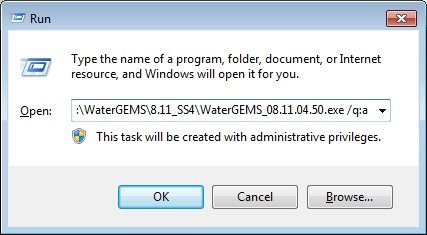

Versions using InstallShield (~2005-~2009)

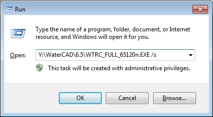

Versions of the OpenFlows products that use InstallShield technology can be silently installed by running the install file with the /s /v/qn switch. A server script would need to execute this on the client computer, with the install file in a shared/network location.

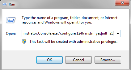

To set a default license feature configuration, (typically done manually in the Municipal License Administrator (MLA), to choose your pipe, inlet or pond limit) use this syntax:
Haestad.LicenseAdministrator.Console.exe /configure <productid> <featurestring>
Where <productid> is the ID corresponding to the Bentley application and <featurestring> is the default feature string you want to set. A typical feature string looks something like this: acad=yes|agis=yes|mstn=yes|pipe=250. Of course, you will need to be licensed for the feature string you set, else the product will not activate (and may run in Disconnected Mode for a limited period of time).

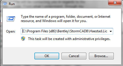

To find other configurations open the municipal license administrator and right click on the row with the configuration you want to set and choose "Properties". The configuration can be copied from the window and used in the commands below.
If running this command from the client's computer, use the Run command with the full path to the executable file. The Haestad.LicenseAdministrator.Console.exe file will be located in the product's installation folder. The path depends on where you originally directed the program to install and whether the operating system is 32 ot 64-bit. For example, the Run window for StormCAD running on a 64-bit version of Windows 7 would be like this:
Use this format if executing using the Run command:
C:\Program Files (x86)\Bentley\StormCAD8\Haestad.LicenseAdministrator.Console.exe /configure 1246 "mstn=yes|inlt=25"
Use this format if executing from the DOS command window of a batch file:
timeout /t 3
An example file of this script can be downloaded here.
