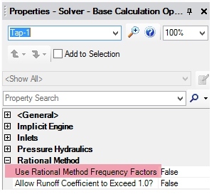

Applying a C adjustment factor in OpenFlows Storm and OpenFlows Sewer
Starting with V8i SELECTseries 5 of the storm and sewer products, a calculation option is available to set Rational Method Frequency Factors. This enables you to apply a multiplier to the Rational C for all catchments, and have that multiplier be different for each return event.
 With the use of a Frequency Factor term the Rational Method effectively becomes:
Q=C'iA
Q = Rational Flow
C' = Runoff Coefficient (Adjusted)
i = Intensity
A = Drainage Area
C'=CfC
Cf = Frequency Factor corresponding to the storm's Return Period (T)
C = Runoff Coefficient (Unadjusted)
You can enable use of frequency option through the calculation options.
Note: Starting with OpenFlows Storm 2026 and OpenFlows Sewer 2026 (version 26.00.00.XXX), you can now use the same frequency factor for multiple return events, similar to the screenshot below.
