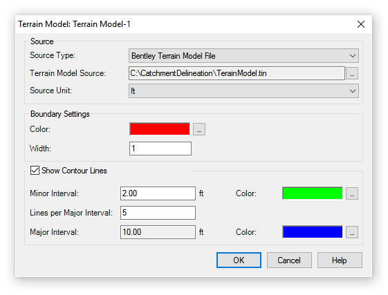

1. Attach the Digital Terrain Model (DTM) which will be used to determine the contributing catchment areas.
a. Open the Terrain Models Manager (View > Surface Views > Terrain Models).
See:
b. Click the New icon to open the DTM (Digital Terrain Model) settings dialog.
See: Help "Terrain Model Settings Dialog"
c. Specify the Source Type, Terrain Model Source file, and the Source Unit to be used.
d. Check the box "Show Contour Lines". See this short video about more functionality on this: A tip on displaying terrain model contours in your hydraulic model
e. Adjust the interval values and colors as needed. Click OK

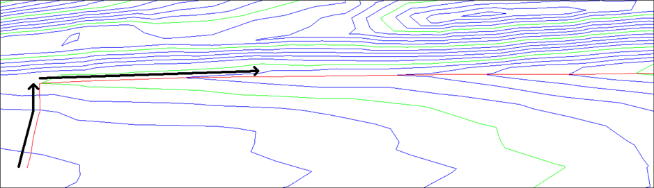

3. In the Terrain Models Manager, select the Downstream Trace button. Use the downstream trace tool to locate the upstream end and to locate where the trace lines drain to.

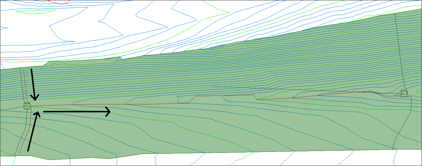

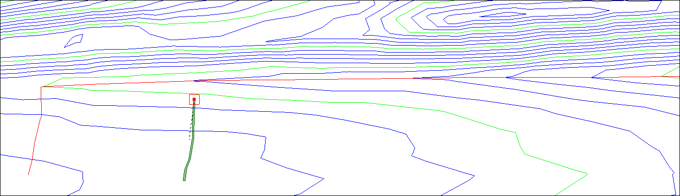

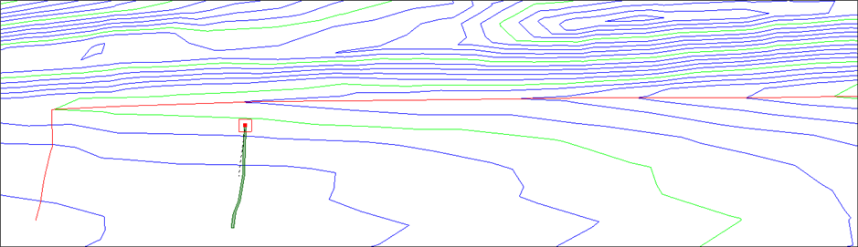

5. Place a catch basin in the candidate spot based on the downstream trace.

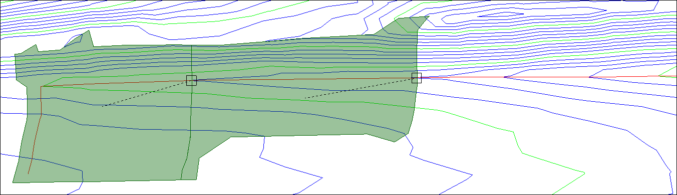

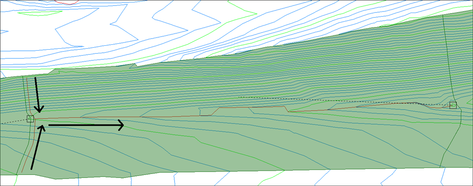

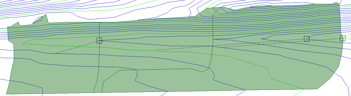

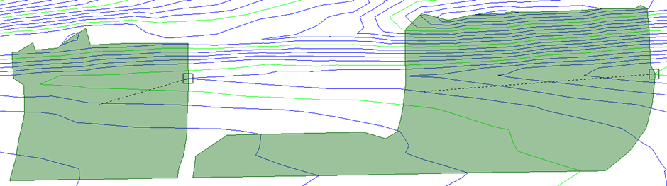

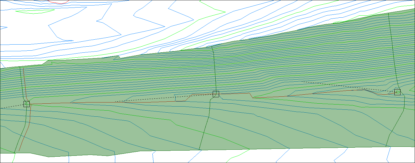

Example of misplaced catchment (catch basin is not on downstream trace line)
See the section below "Moving the catch basin and updating the contributing catchment area".

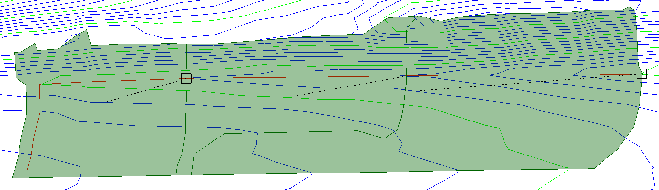

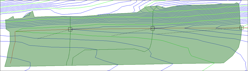

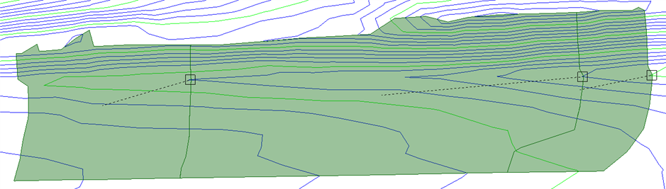

Example showing good placement (all upstream area turns into catchment)

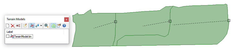

6. Repeat step 5 for the other catch basins. Start at the upstream end and work your way downstream. When working from upstream to downstream, the downstream catchment is aware of the upstream catchment and they won't overlap.
7. Uncheck the box in the Terrain Model Manager to turn off contours and better see catchment separation.
8. Repeat this process until the area in question is completed. Then a new section can be started.

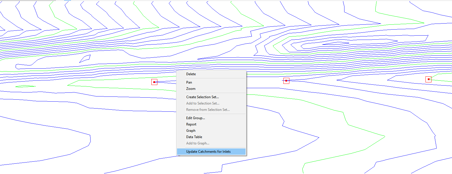

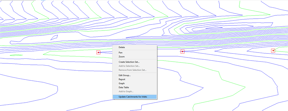

If a model already contains catch basins just select all of them, right-click in the drawing pane and select "Update Catchments for Inlets". Catchments will be automatically created for all of the catch basins that are selected without any overlapping.

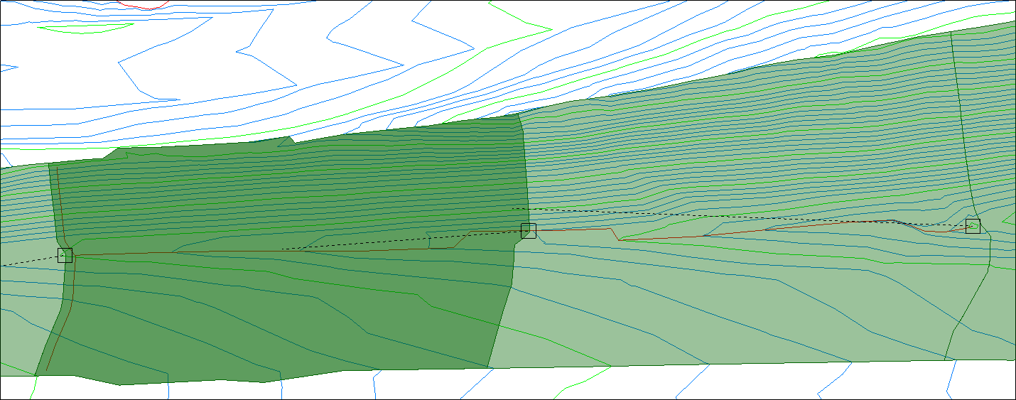

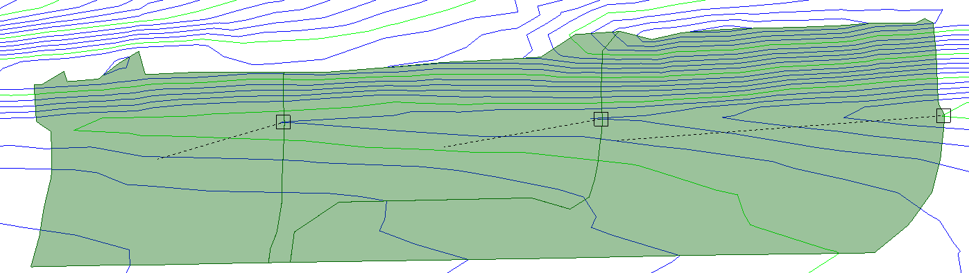

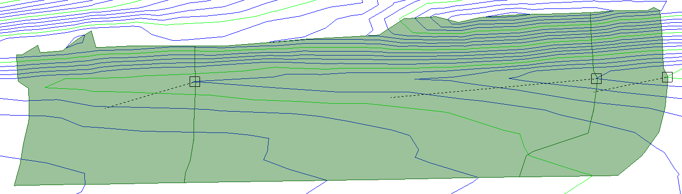

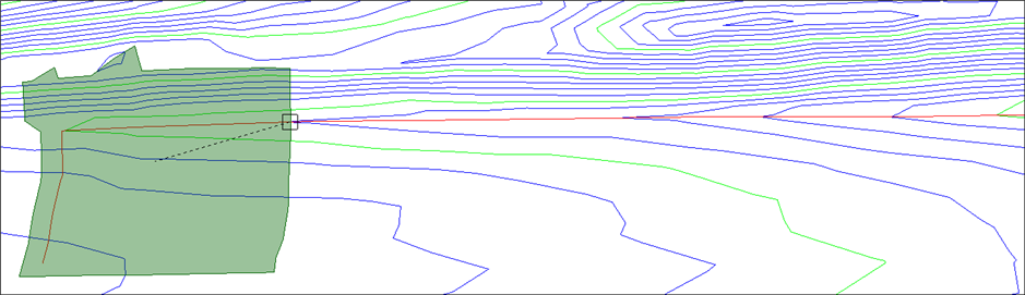

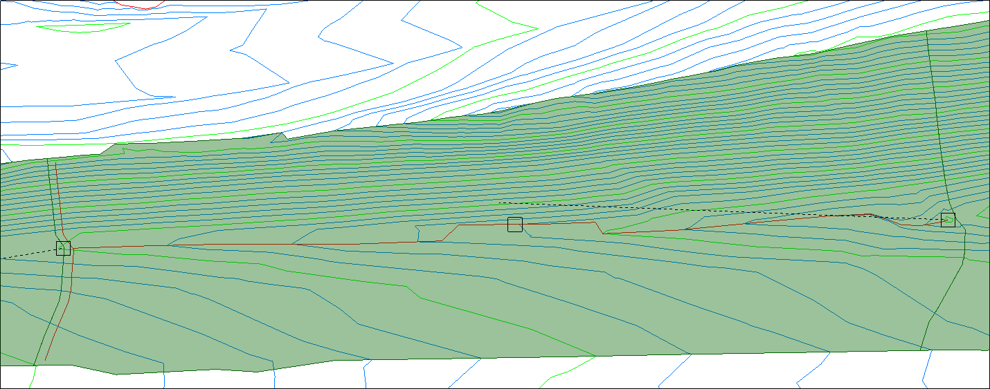

When the "Run Catchment Delineation" button is enabled, moving a catch basin will automatically update the contributing catchment area as well as adjacent downstream catchment areas. For example, when the middle catch basin below is moved to the right, the downstream catchment boundary is automatically updated.

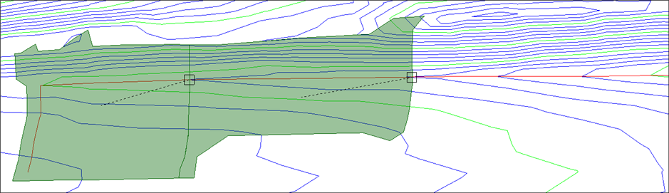

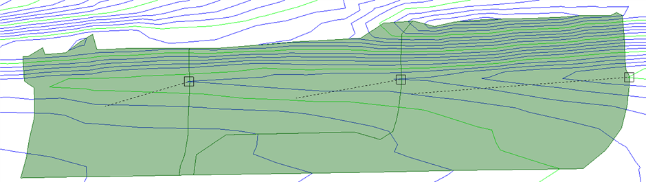

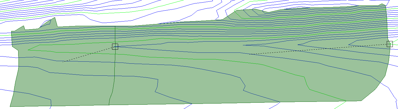

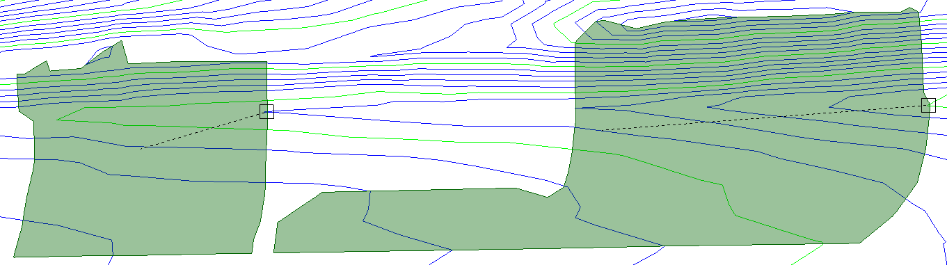

When the "Run Catchment Delineation" button is disabled and a catch basin is moved, then it's catchment and the downstream catchment will not be updated automatically. Both will need to be updated by right-clicking on the catch basin and selecting "Update Catchments for Inlets" (starting at the upstream catch basin).
For example, when the middle catch basin below is moved to the right, with the "Run Catchment Delineation" button disabled, then the catchments remain the same.

If the "Run Catchment Delineation" tool was disabled, then a catchment will not be created automatically. You will need to Right-click on the new catch basin and select "Update Catchments for Inlets".
3. Right-click on the downstream inlet (associated with the catchment being divided) and select "Update Catchments for Inlets".
Deleting catch basins or catchments

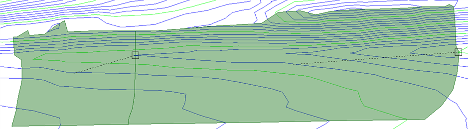

Example: You might have placed too many catchments and want to remove one of them. Deleting the catch basin and the associated catchment will leave a gap.
The downstream catch basin can be updated to include the deleted upstream catchment area by right clicking on the catch basin and selecting "Update Catchments for Inlets".

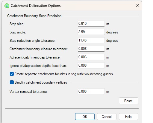

Advanced Settings
There are several parameters that can be adjusted to improve the performance of the automated catchment delineation. The default values for these parameters are usually adequate so you should generally avoid changing them without good reason.  The parameters are described in the help topic "Catchment Delineation Settings".
