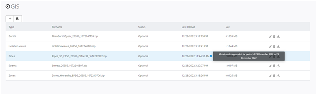

If a zone is created (under Admin >> Zones) but if it does not exist in the uploaded zone shapefile, it will not be displayed in the map but will be listed as greyed out in the side panel - Figure 2. If a zone is created (under Admin >> Zones) but the name in the shapefile does not exact match the one under Admin >> Zones, WaterSight will ignore that zone in the uploaded shapefile.

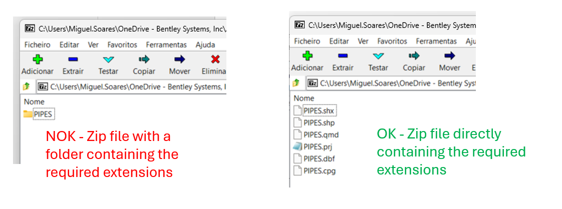

The Zip file structure needs to include all extensions mentioned above and can not contain any other folder inside, otherwise you will get an error when uploading, such as "Upload Failed: One of FileNames is null or empty."
The zip structure should directly contain the required extensions listed above. Example below.

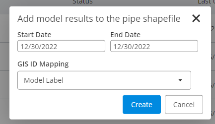

When clicking in the button, a pop-up dialog will appear for the user to define the period for which model results will be calculated as well to define the mapping field between the pipes in the WaterGEMS model and in the uploaded pipe shapefile.
Start and End Date
User defines the period for which model results statistics will be calculated. Please note that the time period defined needs to be within the time window period for which model results exist and are saved in WaterSight. This usually means the last 7 days, or in case an hydraulic model was recently uploaded, the last day/days.
Note: Go to the Realtime Simulation dashboard, to the Previous Simulations page and check for the oldest and most recent dates. This will be the time window period for which model results statistics can be calculated.

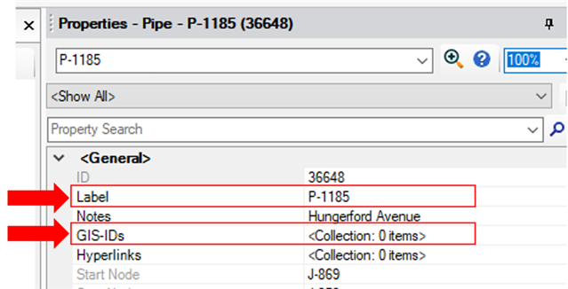

GIS ID Mapping
This is where the user defines the mapping field between the pipes ID in the WaterGEMS model and the pipes ID in the shapefile.
For the pipe shapefile, it is a requirement that a column named "ID" exists. Regarding the WaterGEMS model, the matching can be done against the WaterGEMS field called "Label" or the WaterGEMS field called "GIS ID". Best practice is to use a unique ID from the GIS, software, and associate that to the GIS-ID field within WaterGEMS. This supports multiple GIS-IDs for a single pipe, such as in the case of merging multiple pipe segments into a single model pipe.
Figure 1 - Label and GIS-ID fields within WaterGEMS application
After defining a time period and the mapping and clicking in the "Create" button, and after the process has run, an information symbol with a tooltip will get displayed, with the information that model results were appended to the pipe shapefile and the respective time period that was used (example below). In addition to this, automatically these results will be available inside the capital planning module. More information about how to use the added model results statistics within WaterSight, please click here.
