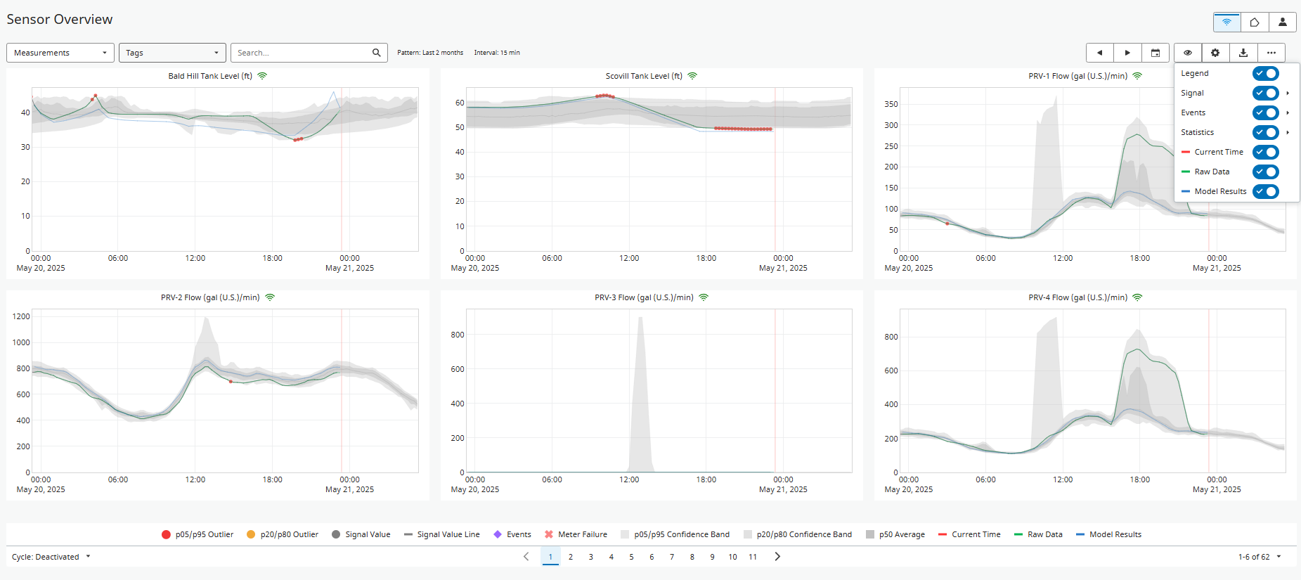

The Sensor Overview pages show side by side graphs of every sensor (configured in the Sensor Administration page). The main goal is to provide an at-a-glance indication if "patterned" variables lie within the expected range of values​. Particularly useful to quickly spot any anomalies (that can represent bursts, leaks, tank overflows, pressure problems, maintenance works, etc) in real time.
Sensor graphs

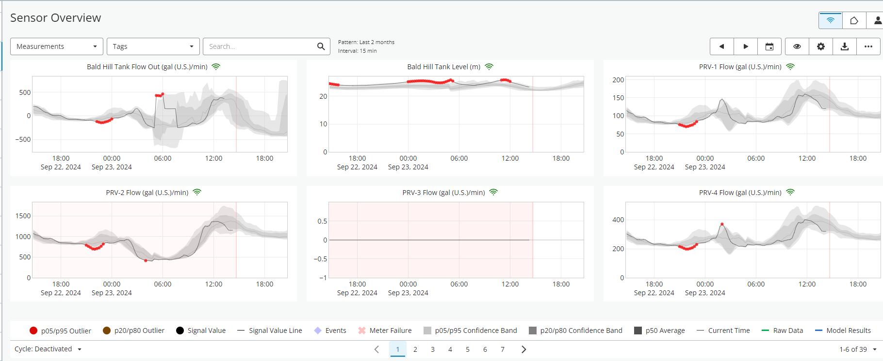

By default up to 6 graphs are displaying chart readings of the past 24 hours and a forecast of 6 hours. The time range period considered for all graphs can be changed by pressing the calendar icon button .
The grey band on each chart represents the pattern confidence bands computed from last two months of historical sensor readings. A pattern corresponds to an expected behavior for the sensor. In OpenFlows WaterSight pattern confidence bands are computed for each sensor using advanced data analytics (statistic equations together with machine learning techniques to remove outliers or bad data). For these calculations several considerations such as the data history for each specific sensor as well as the distinction between week-day and weekend are taking into consideration.
A wide grey band indicates that there were large variations in the sensor values during the time period for which the bands were developed. A narrow band indicates that the sensor value has been relatively constant at that time of day for the time period (hour and day of week) for which the bands were developed.
Real raw values are re-sampled in every 15 minutes and are represented as a black, red or orange circles. Whenever real data (re-sampled) goes outside the pattern confidence bands (above percentile 95 or below percentile 5 of the pattern), an outlier is identified and the value is color coded with a red circle.
If there is not enough historical data to compute the pattern confidence bands an informative message is displayed, and only real (re-sampled) values are shown. Clicking on this message removes the message.
Patterns can be customized by the user in the Administration page, under Settings > Pattern.
Note: Sensors will display in descending priority. Highest priority first. Sensors with a priority of 0 will not be displayed in the overview. The priority of each sensor is defined at the Sensors configuration, in the administration page.

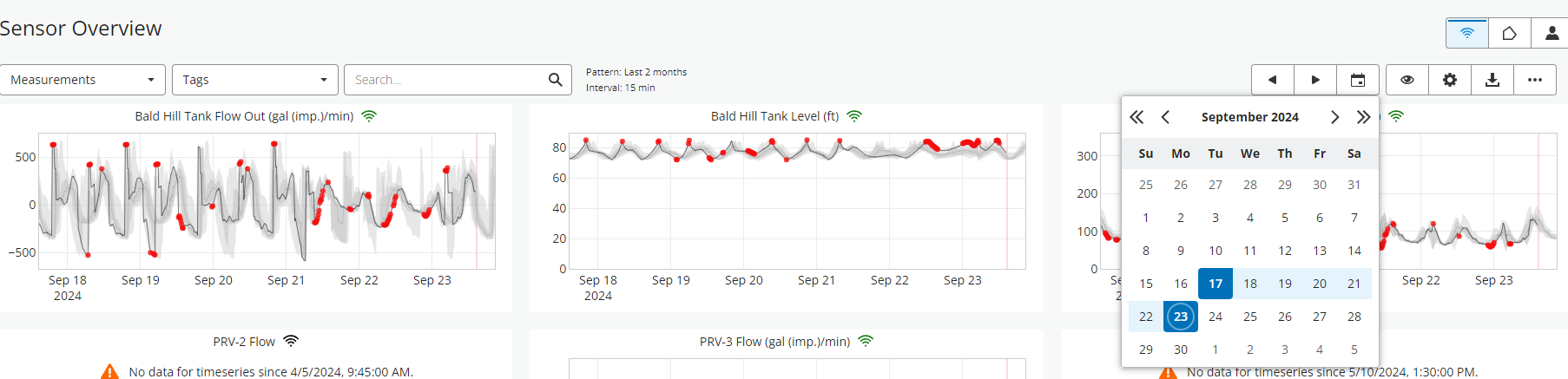

Calendar Icon - select different time periods
Press calendar icon as well as the left and right arrows to select different periods for the overview time series that are displayed, including any historical period. Once selected, all the overview graph dates will updated accordingly with the selection.

Click on the visibility button, under the graphic tools, to add model results and raw data in the graphs. More information below.
Graphic Tools
Use the graphic toolbar to control the display of the charts shown on the sensor card, with the possibility to add additional information:
Entry Description
Turn on/off:
- Legend of the graphs
- Signal data
- Events highlighted in the graphs (with the additional flexibility to display only active events or all events)
- Statistics (or patterns)
- Current time marker
- Raw data
- Model results
Turn on/off "full y-Range option" in graphs and define the time period for the graphs (last 6 hours, last 12 hours, last day, last two days, last three days, last week)
 Download data that is being displayed on graphs (PNG or CSV format)
More graph configurations: spike lines, data tooltip and font size.
