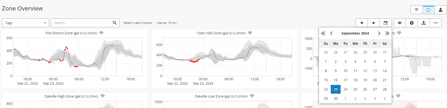

Zone overview provides a dashboard for at-a-glance indication if the current zone flow lies within the expected range of values. Particularly useful to quickly spot any anomalies (that can represent bursts, leaks, tank overflows, pressure problems, maintenance works, etc) in real time, inside a specific zone.

By default up to 6 graphs are displaying chart readings of the past 24 hours and a forecast of 6 hours. The time range period considered for all graphs can be changed by pressing the calendar icon button

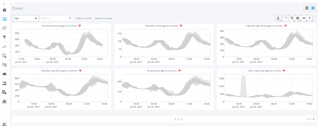

The number of zones to be displayed simultaneously is limited by page - the user has the option to navigate to the following pages to see the remaining zones or search for a specific one. The current page and the number of charts that are displayed on a page are identified at the top left of the page.

The grey band on each chart represents the pattern confidence bands computed from one month of historical sensor readings within the zone. A pattern corresponds to an expected behavior for the zone. In OpenFlows WaterSight pattern bands are computed for each zone using advanced data analytics (statistic equations together with machine learning techniques to remove outliers or bad data). For these calculations several considerations such as the data history for each specific sensor as well as the distinction between week-day and weekend are taking into consideration.
A wide grey band indicates that there were large variations in flow during the time period for which the bands were developed. A narrow band indicates that the flow has been relatively constant at that time of day for the time period (hour and day of week) for which the bands were developed. If there is not enough historical data to compute the pattern confidence bands an informative message is displayed, and only real (re-sampled) values are shown. Clicking on this message removes the message.

Real (re-sampled) values are represented as a black, red or orange circles. Those real (re-sampled) values are calculated based on the final balance between all inflows and outflows (plus accounting for storage inside the zone if exists). Whenever real data (re-sampled) goes outside the pattern confidence bands (above percentile 95 or below percentile 5 of the pattern), an outlier is identified and the value is color coded with a red circle.

Calendar Icon - select different time periods
Press calendar icon as well as the left and right arrows to select different periods for the overview time series that are displayed, including any historical period. Once selected, all the overview graph dates will updated accordingly with the selection.

Paginator
The paginator at the bottom of the page divides the set of available zones into "pages" and controls which page is being displayed. The number of charts per page can be picked from the "Charts per Page" dropdown.
Charts per Page
At the bottom right corner of the page, the user can select the number of charts to as grid on the page
Entry Grid Size
6 charts per Page 3 x 2
9 charts per Page 3 x 3
12 charts per Page 4 x 3
15 charts per Page 5 x 3
