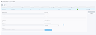

In the Numerical Models Administration page the user can:
This configuration page is used to upload the hydraulic model and set the options for the automated real time simulation.
Sensors measurements can be used as boundary conditions for the hydraulic model runs, contributing to increase the confidence in the model calculated results (such as tank levels, PRV settings, pump status and relative speed, etc). Besides this, zone patterns and hydraulic grade line patterns for tanks and reservoirs can also be used as boundary conditions for the model runs, but in this case they are not applied only for initial conditions, but rather to the all simulation period. More information can be found here.
The uploaded WaterGEMS model will automatically run in WaterSight, at a given frequency defined by the user and also considering the hindcast and forecast period defined (more detail below). If the WaterGEMS model contains more than one scenario, only the active scenario will be considered in WaterSight.

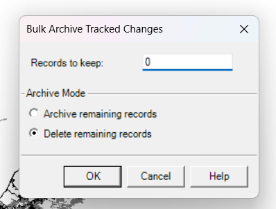

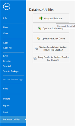

to increase model performance in WaterSight, please make sure to:
delete all track changes from the WaterGEMS model. To delete track changes go to the review tab in WaterGEMS >> select Bulk Archive >> delete records (see image below). After that, please make sure to compact database, by acceding to File >> Database utilities >> Compact Database. At the end, make sure to save the file. This workflow can significantly reduce the size of the SQLite file in case the utility is using the track change functionality quite often.
| Fig 1 - Delete track changes in the WaterGEMS model | Fig 2 - Compact Database in WaterGEMS |

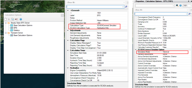

Two submodels uploaded into WaterSight
Figure 1 - Updating calculation options in the WaterGEMS prior uploading into WaterSight.
SCADA or other telemetry data can be used to set the initial conditions for the model run when they are correctly configured in the uploaded WaterGEMS model. More information here.

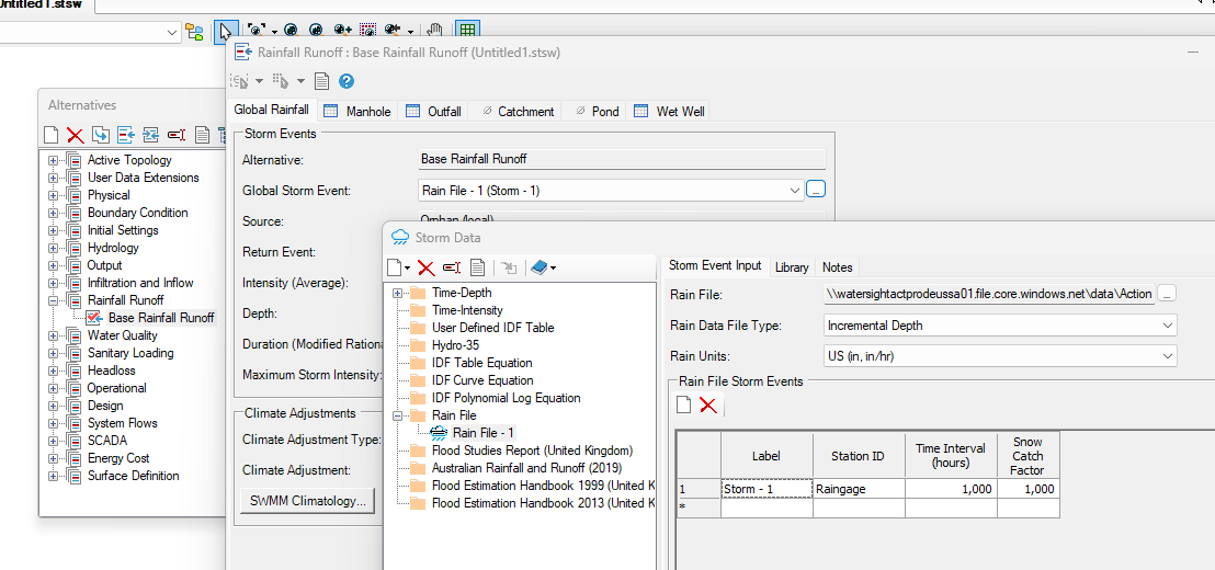

WaterSight can also support the upload of a Sewer Model from SewerGEMS. For that, it is required first to create a digital twin which type is water collection.
The required settings to upload a sewer model in WaterSight are the following:
In SewerGEMS (SWMM Solver) it is possible to connect junction and storage nodes such as Manholes, CSs, inlets, Wetwells, Ponds to import Initial Depth values. It also can import values of Initial Flow for Gravity Conduits/Channels, and Pump's Status, Relative Speed Factor. It's important to notice that values on Pollutant/Contaminant concentration from Sensors are not imported as initial conditions by default on SewerGEMS. Once configured in SewerGEMS (SCADA elements are created and associated with the model element), those can be supported in WaterSight.
Click in the "Add" button (+) located on top to add a new hydraulic model.
Tips: Only one hydraulic model file is supported by digital twin however it is possible to aggregate several model files into one using the import submodel feature available in WaterGEMS. More information above, under General tips. To upload a new model file, it is strongly suggested to upload a ZIP extension (just including the sqlite extension) and to turn off and delete track changes

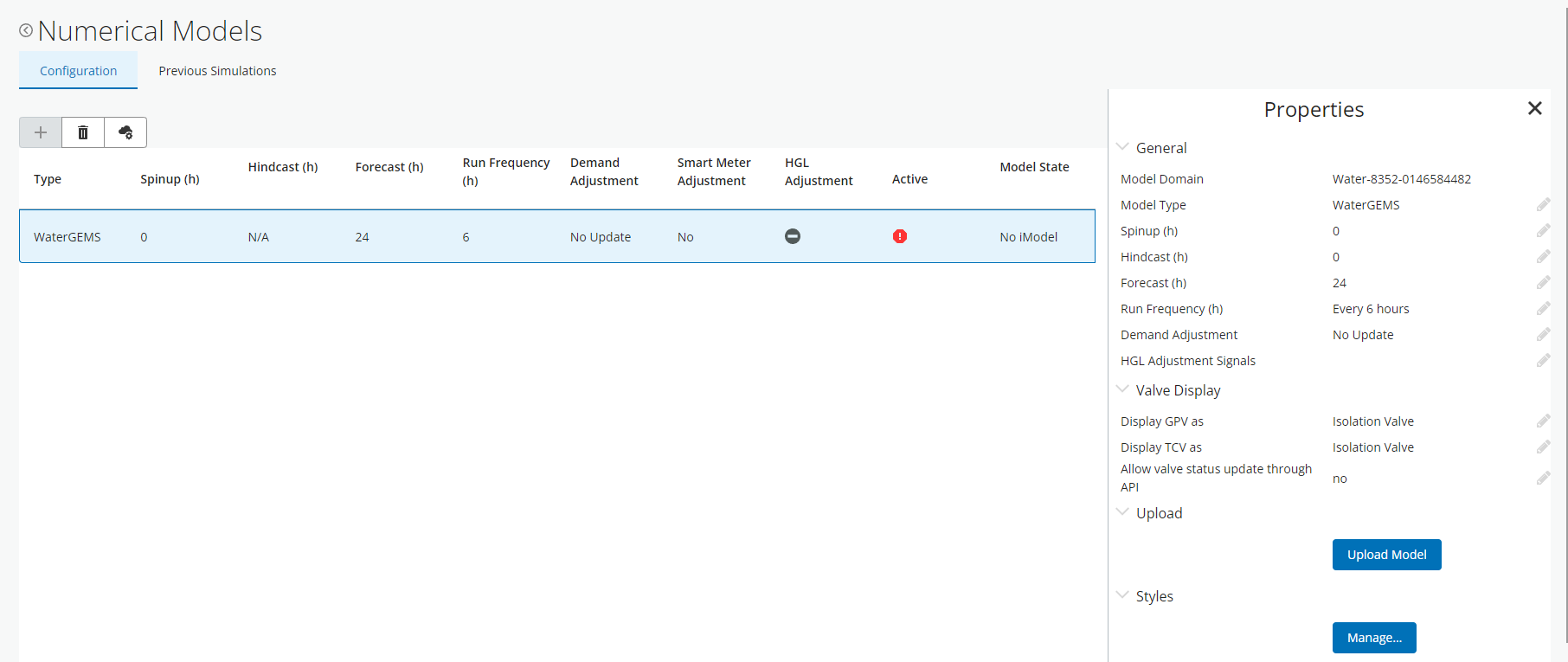

Once clicking "Add", a new row in the table will appear and the user can now upload and edit the configurations of the new model. For that, make sure to click on the row and edit the right side panel that will appear.
Click in the row and then click in the delete button to delete the entire hydraulic model. A new hydraulic model can then be uploaded again.
Note: It is also possible to reupload a new model without needing to delete the previous one - ideal workflow once the user wants to update a more recent model. For reupload of a new model just click on the first row and then in the right side panel press the upload Model button and upload the latest model.

Time period at the start of a model run where the results are considered unstable and are not displayed. This is particularly important for model runs where initial inertia is important. For water supply models spinup this can be relevant when simulating water quality. In most cases this value can be set to 0, as consecutive model runs use previous results to update initial settings.
The Hindcast is a time period of time leading up to the current time where past model calculated results can be compared with historical sensor values. A hindcast period of 12-24 hours is useful for calibrating and validating a near-realtime hydraulic model, as well as in giving context to current and forecast conditions. If the model is configured with Control Overrides from SCADA sensors, a hindcast period can have accurate behavior of pump and valve setpoints even if logical controls have not been fully defined in the model.
The time period into the future, starting from the current time, for which model results will be calculated. Note that the forecast period cannot take advantage of SCADA Control Overrides, so controls must be defined in the model which appropriately mimic both automated setpoints and typical manual adjustments to pump and valve operations. When first developing a near-realtime hydraulic model, it is often best to focus first on calibrating an accurate hindcast, and then refine controls to improve the forecast.
Results of each model run are automatically saved in the Previous Simulations page.
Define the automatic run frequency of the model. For example if 1 hour is defined, this means that the model will automatically run every hour.

Turn the model active or inactive. If inactive, the hydraulic model will not appear in WaterSight and the Modeling section will not be available.
Display GPV as
In case user uses GPV valves in the WaterGEMS model file, those can be considered in WaterSight as Isolation Valve (default) or as Control Valve. In case they are considered as Isolation Valve, they will appear in the Current Simulation page under the Isolation valve group dropdown. In case they are considered as Control Valve, they will appear under the Control Valve group dropdown.
Display TCV as
In case user uses TCV valves in the WaterGEMS model file, those can be considered in WaterSight as Isolation Valve (default) or as Control Valve. In case they are considered as Isolation Valve, they will appear in the Current Simulation page under the Isolation valve group dropdown. In case they are considered as Control Valve, they will appear under the Control Valve group dropdown.
Allow valve status update through API
Making sure that valve status in WaterSight are updated is very important to achieve good confidence on the model results. With WaterSight it is possible to directly and automatically update valve status for example based on the latest GIS information, through an API. For more information, please contact your Bentley technical support person.
Click here to directly upload a WaterGEMS model - can be sqlite file or ZIP file extension. To assure a fastest upload, it is strongly suggested to use the ZIP extension (just including the sqlite extension) and to turn off and delete track changes in the WaterGEMS model. The upload Model button should also be used for further reuploads of the hydraulic model.
