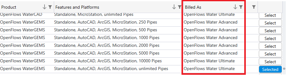

As noted in the above article, the installation files include a suite of applications. For example, OpenFlows Water includes WaterGEMS, WaterCAD, and HAMMER; OpenFlows Sewer includes SewerGEMS and SewerCAD; OpenFlows Storm includes StormCAD and CivilStorm; and OpenFlows Hydraulic Toolset includes FlowMaster and CulvertMaster. How the applications are installed will depend on what you are licensed to use. The section called "OpenFlows 24.00.01.05 and higher Product Installation" in the link above has details on this workflow.
This will not have a significant impact on the license activation through the Feature Level Selector. You will still select the feature level that you own in the Feature Level Selector to activate the license. The chart in the article above, and in the FAQs linked to from the bottom of the next article, explain which feature levels are granted for each tier of the new products. You will also see a "Billed As" column in the Feature Level Selector, to clarify which license tier the respective feature level will bill as:

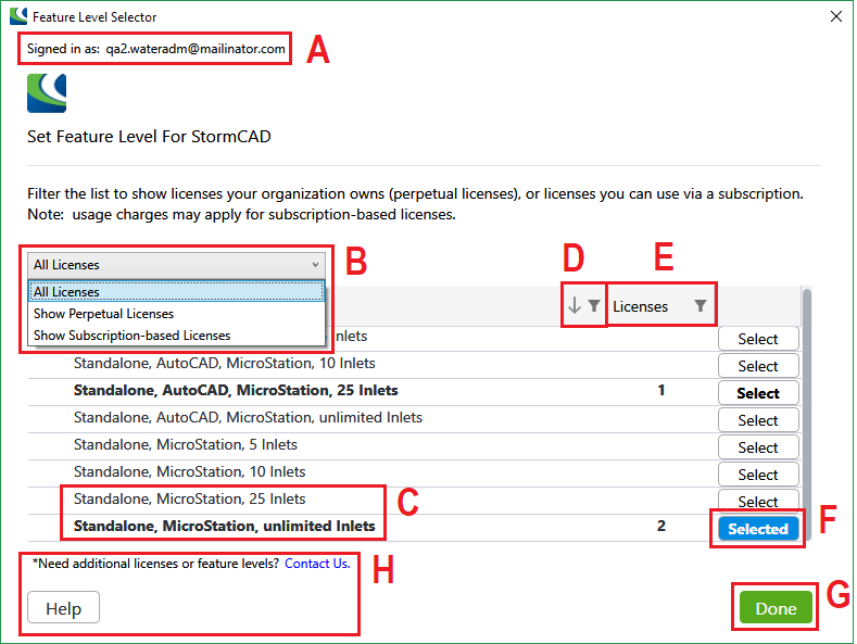

Highlights of the Feature Level Selector
Components
A - The user account currently using the product. When the feature level is set, it will be set for this user account. For help, see: Bentley user registration - Connected User setup
B - This dropdown menu enables you to filter the type of feature levels displayed in the table. By default, it will show Perpetual licenses, to help guide you toward selecting your owned, perpetual license, while still enabling you to select a higher, subscription-based feature level if you need to (and accept that you will receive a term license).
C - Perpetual (owned) licenses are shown in bold font.
D - You can sort and filter the list of license feature levels if needed. When opening the Feature Level Selector from within the License Tool, a Product column will also be displayed, with a sort/filter available.
E - The "Licenses" column indicates the number of perpetual licenses owned of a respective feature level.
F - Click the "Select" button to select a feature level that you want to use. When selected, the button will display as blue with "Selected".
G - Once you have selected a feature level, the "Done" button becomes available, as the final step of the process. When clicked, the Feature Level Selector will close and the product will attempt to open with that feature level. The next step is to check for General Access and Concurrent use Thresholds (see below)
H - The "contact us" button directs you to the form to request more licenses (for example if you need to purchase a license or subscription to gain access to a higher feature level. The "Help" button links to the following article for general help: Licensing OpenFlows products - Subscription Entitlement Service (CONNECT Licensing)

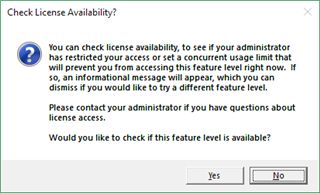

License Availability Check (General Access and Concurrent Use Threshold Alerts)
When choosing to "Select" a feature level in the Feature Level Selector ('F' above), you may be prompted if you would like to check if the feature level is available. Choose "Yes" to check if your license administrator has restricted your permissions ("General Access" settings), or if a threshold was set (concurrent use threshold alerts) and all licenses are currently in use (these are configured in Entitlement Management.) This check should only take a few additional seconds, and gives you the opportunity to select another feature level if needed (since the Feature Level Selector will still be open.) Otherwise if the license is not available, you would need to re-open the Feature Level Selector (see "Changing the Feature Level" below) in order to choose another feature level.
Note: this prompt will not appear if you have accessed the Feature Level Selector from within the Bentley Licensing Tool (separate tool/shortcut)
An "Access Denied" message box indicates that your administrator has restricted your access to this particular feature level (but not necessarily other feature levels for the product you are trying to use). Dismiss this message box to return to the Feature Level Selector, to select another feature level for that product, if available. Contact your license Administrator (typically in your IT or Helpdesk) if you believe that you should have access.
A "License Information" message box that indicates that your license administrator has set a threshold on the number of concurrent usages of that particular feature level, and all licenses are currently in use by other users. This often means that if you continue and open the product, your organization will incur usage charges. This may be acceptable during times when multiple users need to be working in the software, in which case you can click the "acknowledge" button. This records the event and may alert the license administrator to your choice. When this appears during the availability check in the Feature Level Selector (see above), "acknowledge" results in the feature level being selected, after which you can click "Done" and open the product. You may encounter a second instance of this dialog box when doing so.

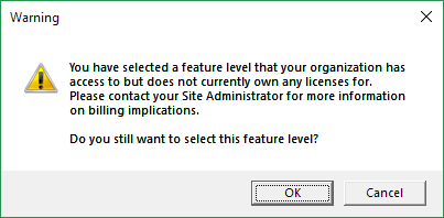

Selecting Subscription-based (Non-Owned) Feature Levels
If you select a subscription-based feature level (one you do not own a perpetual license of), you will be presented with the following warning about usage charge implications. This is an extra measure to ensure that the end user understands the implications of selecting such a feature level.
There may be cases where you want to take advantage of the benefits of your subscription and accept that you may receive a term license charge (for SELECT OpenAccess) for the use of the feature level you need.
If you click OK, the feature level will be selected and you can click "Done" to complete the feature level selection process and start the application.
If you click Cancel, the feature level will NOT be selected and you must select another feature level before the "Done" button becomes available.
"You have selected a feature level that your organization has access to but does not currently own any licenses for. Please contact your Site Administrator for more information on billing implications."
Note: that for users with an Enterprise License Subscription (ELS / E365) or a Practitioner license all feature levels will be available by default and all may show as being subscription-based, with the above message appearing when you select one. This is expected in a case where your organization only has licenses through their ELS subscription, with no perpetual licenses owned (billing is based on yearly usage.) The message is hidden for ELS users starting with CONNECTION Client version 10.0.18.13 , included in version 10.02.03.XX of the OpenFlows products. Note that Practitioner licenses are also considered "owned" licenses for the sake of feature level selection, which is why you will see this message.

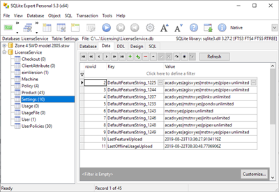

However if you have a need to check what the feature level is from some type of monitoring system, without opening the product or the feature level selector itself, you can do so by looking at the license database file where the feature level setting is stored.
  1. Install a SQLITE browsing application such as SQLITE Expert Personal
  2. On the Windows user profile in question, navigate to C:\Users\<username>\AppData\Local\Bentley\Licensing\
  3. Locate the file named LicenseService.db and open it in your SQLITE viewing application.
  4. Open the table named "Settings" - this will show one row for each product that has a feature level set, with the corresponding feature string. Note that modifying this table is not supported by Bentley.
The four-digit number at the end of the "Key" field determines the product, as shown in the table below.

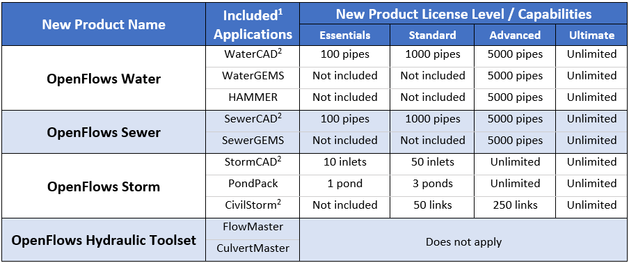

What are the standard feature levels?
Starting July 1st, 2024, the license features have been simplified. See the following table for the license features for the different suite of applications.
