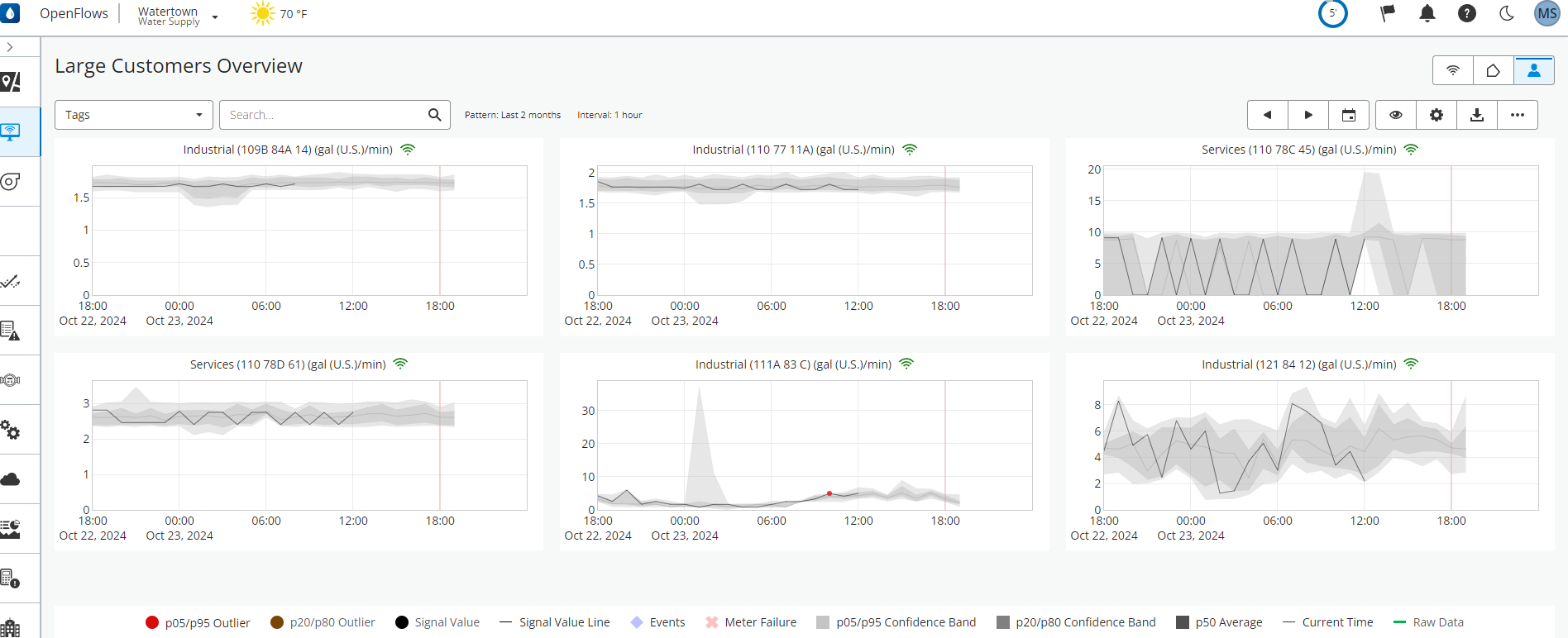

The Large Customer Overview pages show side by side graphs of every large customer sensor (configured in the Smart Meter Administration page). The main goal is to provide an at-a-glance indication if "patterned" variables lie within the expected range of values​. Particularly useful to quickly spot any anomalies at the large customer level (that can represent internal eaks, anomalous decreases in consumption, etc) in real time.
Large Customer graphs
By default up to 6 graphs are displaying chart readings of the past 24 hours and a forecast of 6 hours. The time range period considered for all graphs can be changed by pressing the calendar icon button .
The grey band on each chart represents the pattern confidence bands computed from last two months of historical sensor readings. A pattern corresponds to an expected behavior for the sensor. In OpenFlows WaterSight pattern confidence bands are computed for each sensor using advanced data analytics (statistic equations together with machine learning techniques to remove outliers or bad data). For these calculations several considerations such as the data history for each specific sensor as well as the distinction between week-day and weekend are taking into consideration.
A wide grey band indicates that there were large variations in the sensor values during the time period for which the bands were developed. A narrow band indicates that the sensor value has been relatively constant at that time of day for the time period (hour and day of week) for which the bands were developed.
Real raw values are re-sampled in every 15 minutes and are represented as a black, red or orange circles. Whenever real data (re-sampled) goes outside the pattern confidence bands (above percentile 95 or below percentile 5 of the pattern), an outlier is identified and the value is color coded with a red circle.
If there is not enough historical data to compute the pattern confidence bands an informative message is displayed, and only real (re-sampled) values are shown. Clicking on this message removes the message.
Patterns can be customized by the user in the Administration page, under Settings > Pattern.

Displays the Sensor Name and the color-coded status at the top. Click the Large Sensor Name to navigate the Large Customer Details.
