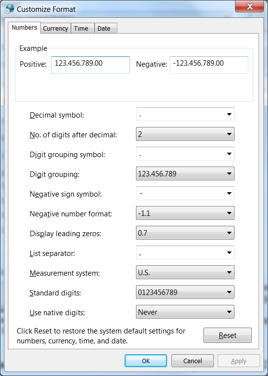

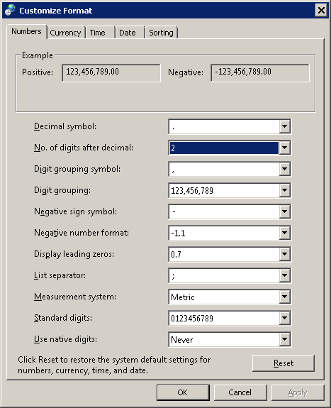

Typically European users of Windows applications change their numeric formatting settings to European standard using Start Menu -> Control Panel -> Region and Language -> Change the date, time, or number format>Additional Settings.  This window appears as shown:
In this dialog box, European users would specify a Decimal Symbol of ‘,’ (comma) and a Digit Grouping Symbol of ‘.’ (period), whereas non-European users would specify a Decimal Symbol of ‘.’ (period) and a Digit Grouping Symbol of ‘,’ (comma).

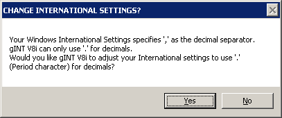

Unfortunately, the European Decimal Symbol and Digit Grouping Symbol settings will not work with gINT.  You will see the following message:
When you click Yes, gINT changes the decimal symbol in the dialog box above.  Change it back to a comma after leaving gINT if you need your other applications (such as Excel and Word) to use European number formatting.

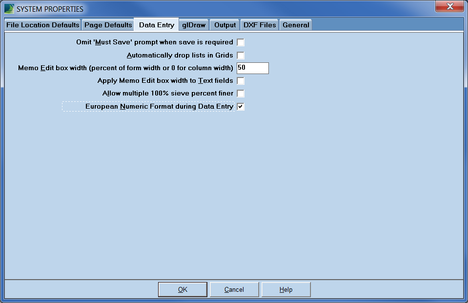

With a global property setting, a comma can be used as the decimal symbol for entering data in input. To change this property setting select File -> System Properties -> Data Entry. The following dialog box appears:
    Check European Numeric Format during Data Entry.

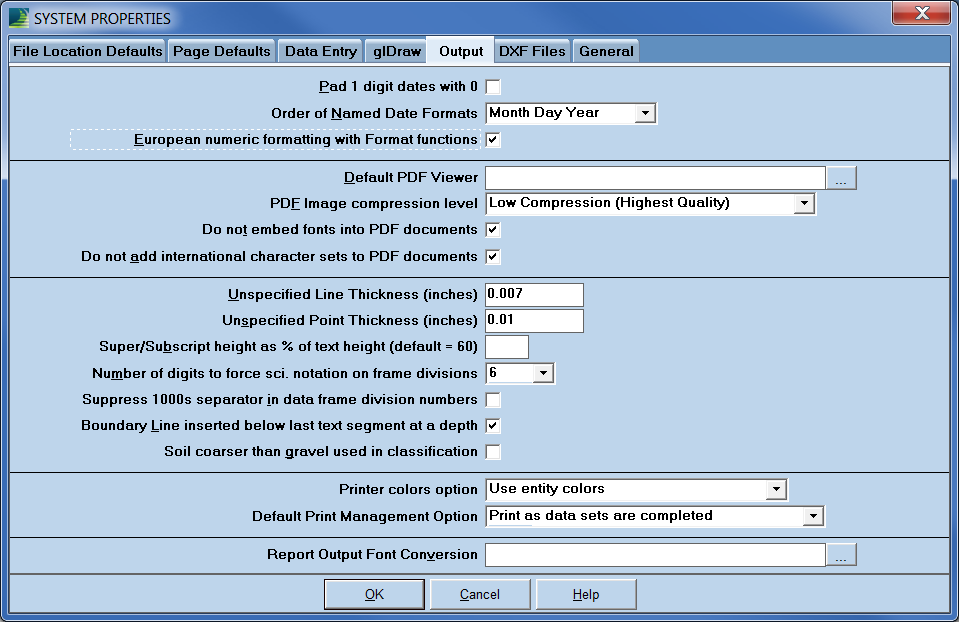

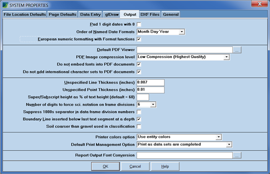

    Within gINT is a global property setting that alters the way format strings in the Format() function (and related functions) are interpreted. This property is called European Numeric Formatting With Format Functions. To change this property setting select File -> System Properties -> Output. The following dialog box appears:
      To change the interpretation of formatting strings in these functions to European standard, check the European Numeric Formatting With Format Functions checkbox. To have gINT interpret these formatting strings using non-European formatting, uncheck this checkbox.
